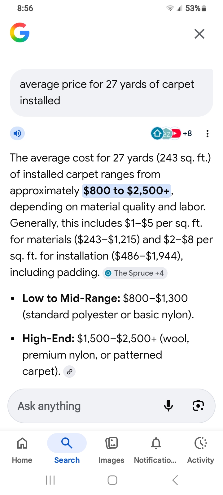

From AI:
"Carpet replacement typically costs
between $3 and $11 per square foot for materials, padding, and labor combined. For a standard 300-square-foot room, this usually ranges from $1,000 to over $1,900. Total costs vary based on carpet quality, style, and labor, with budget options as low as $1 per sq. ft. and luxury, high-end carpets costing $20+ per sq. ft.. "

I cleaned a trashed apartment carpet several months ago and told them it really should be replaced instead of cleaned.
It was 2 small bedrooms. She said she was quoted $1600 from one company, and then $1800 from a different company, to replace the carpet in the 2 bedrooms. That was why she wanted me to clean it. The rooms were about 11x12, and 9x12. I was shocked at how much she was quoted for the replacement.
I would say thats alot!! 55-66.00 per yard, but googling it that's mid range for high end carpet
