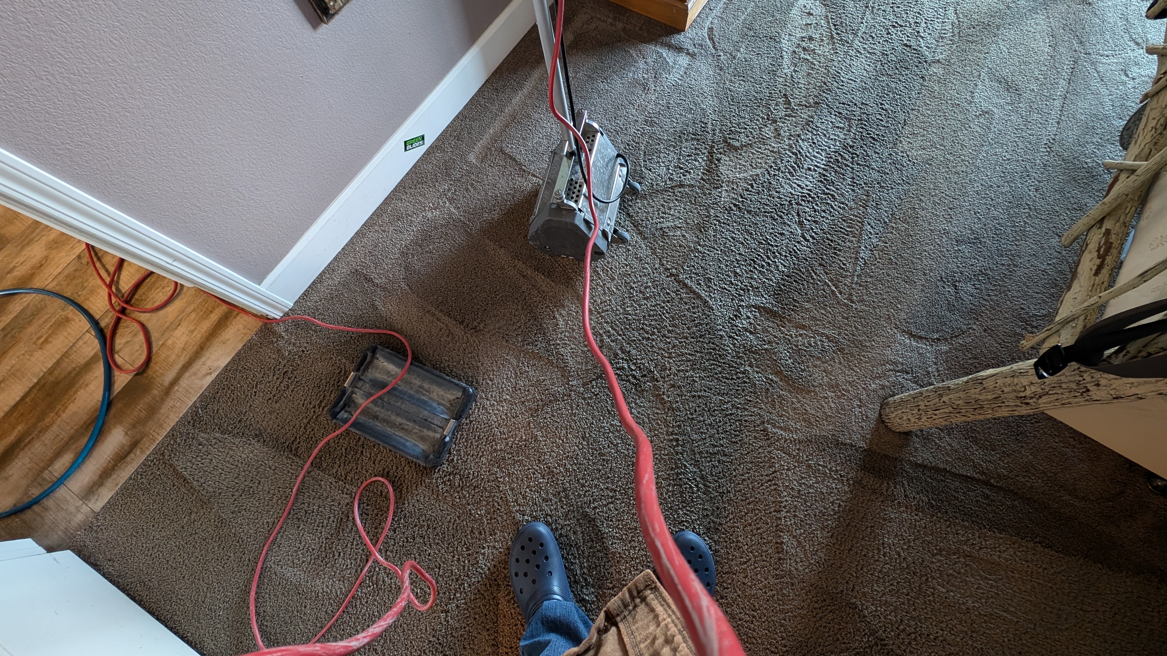

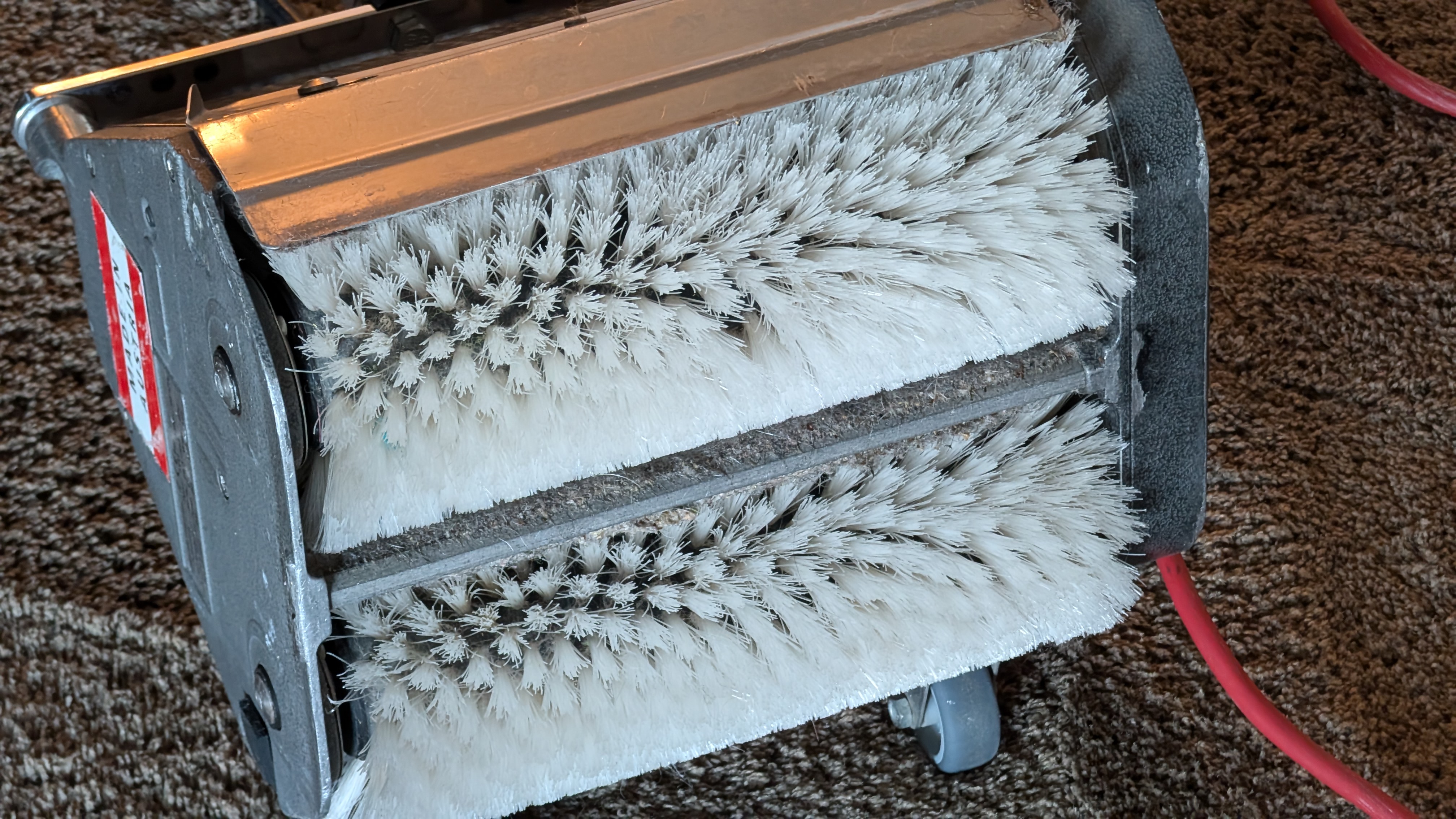

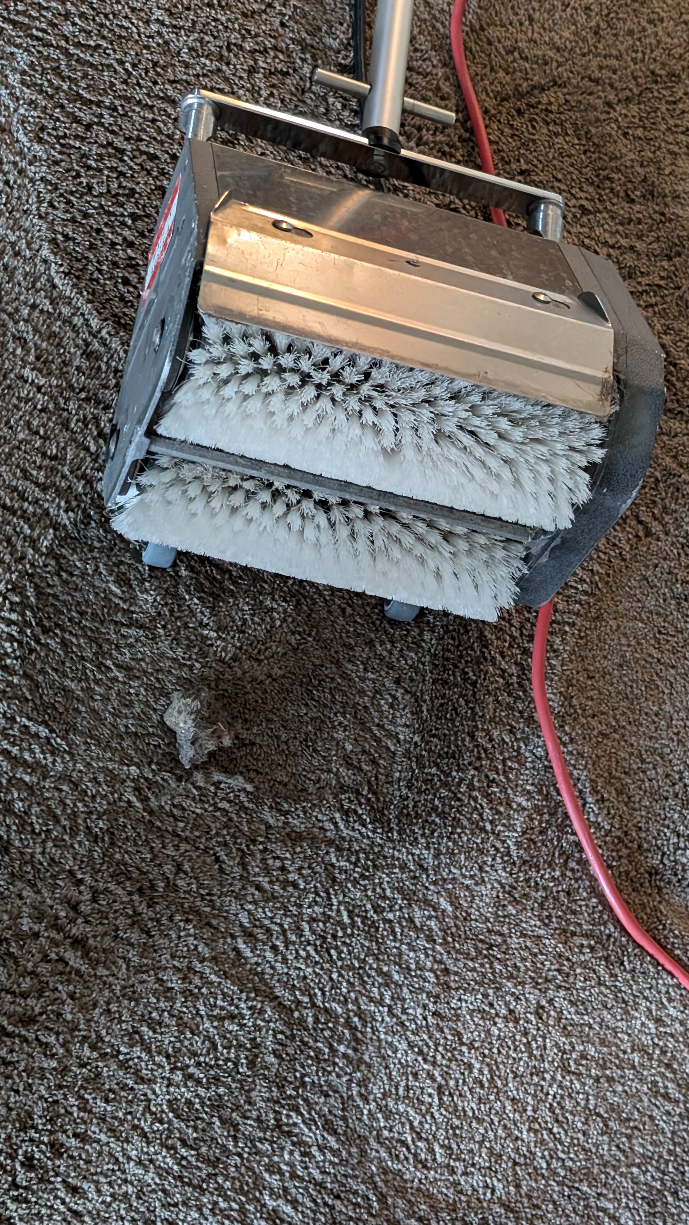

I just CRB'd my own carpet for the first and only time in 10 years, no loose clumps and just a tad in the bar..PXL_20241111_195414803.jpgPXL_20241111_195508380.jpg
