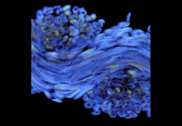

As can be seen in these images, the internal structure of the cotton fiber is hollow and highly absorbent.
So when a Pre-Spray is brushed into the soil on the cotton fabrics surface it dissolves some of that soil and then guess what happens to this dirty liquid?
:?: :idea:
harryhides
4,429
Canada
Tony
Some of the soil which was on the surface of the fiber is sucked into the inner hollow structure of the fiber where it remains leaving a white cotton looking dull and gray.
We have all seen this and in most cases it will not come clean no matter what we throw at it.
The solution is to first wet the cotton fabric with clean ( preferably distilled)
water which will be absorbed into the inside of the cotton fiber. This now creates a barrier to any dirty water being absorbed into the hollow core.
Then apply your Pre-spray, agitate and rinse/towel off.
As the water evaporates from the cotton the inner core will be left cleaner and look better.
Try it.

Maybe I'm hard headed but wouldn't some of the distilled water take some of the dirt with it into the fiber?.
Albert

Albert, it might but it will take far less than any pre-spray would especially if it has been pre-vacuumed. The principle to remember is "first thing in, last thing out".
