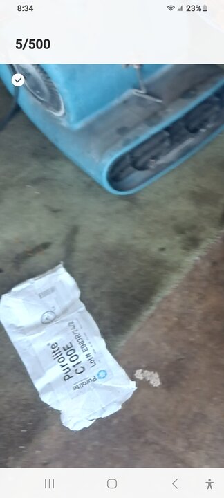

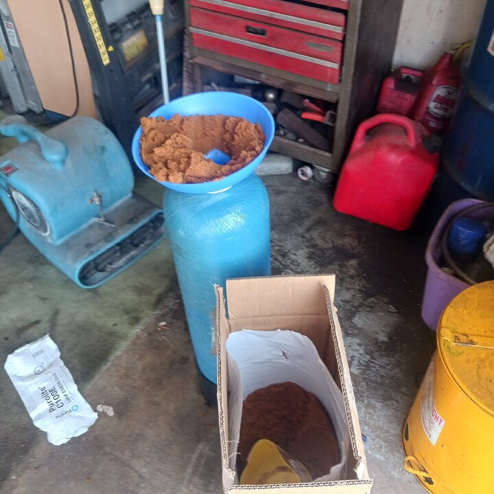

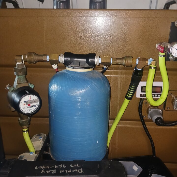

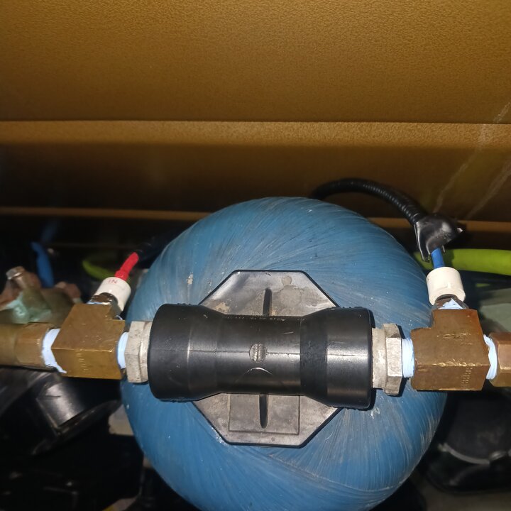

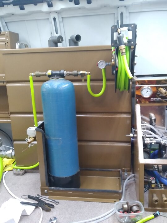

I still use the old prochem softeners.(1 cubic foot) I hear some guys use a little one that they get from Costco. But the amount of time between recharge is (or at least if properly done) a lot shorter ( i also have a flow meter and "kinda hardness meter" installed) you can find them pretty cheap they recharge with a dema valve( like a hydroforce). If you get a used one i recommend replacing the resin. It's supposed to be done every 7 or so years

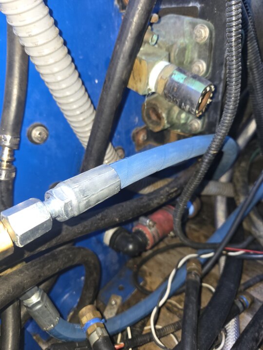

I just finished installing it all today! I was going to post some updates about it tomorrow. I went and swapped out all my high pressure lines with new ones at our local supplier today, and had some new lines made to plumb in the heat exchanger. It all seems to be working well, no leaks in the lines or fittings, and the cavitation is fixed too. I have 3 jobs tomorrow. I hope it all works well and I finally have proper heat.

Bleeder valve, water heater insulation, and a shelf so I can still throw extra hose and things back there. All stainless fittings with stainless steel teflon tape, hopefully it doesn't need any attention for 5 to 10 years :]

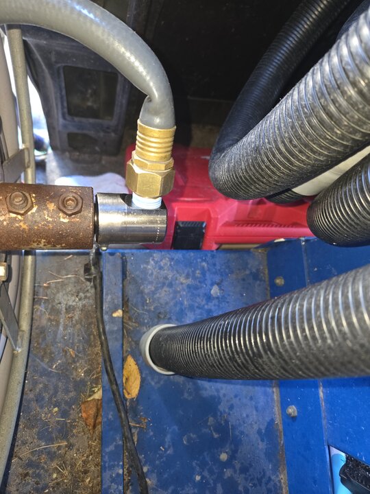

I left my old heat exchanger in place for now. I have no idea how to access the backside of the 2 bolts behind the drivers seat side of the waste tank. It is underneath the vacuum outlet of the waste tank, which looks like it is surrounded by solid steel in each direction. I would need to access the backside in order to properly plug the holes if I remove the factory heat exchanger bolts on that side. I sense that I am missing something because they had to access it to install the thing. Meh...

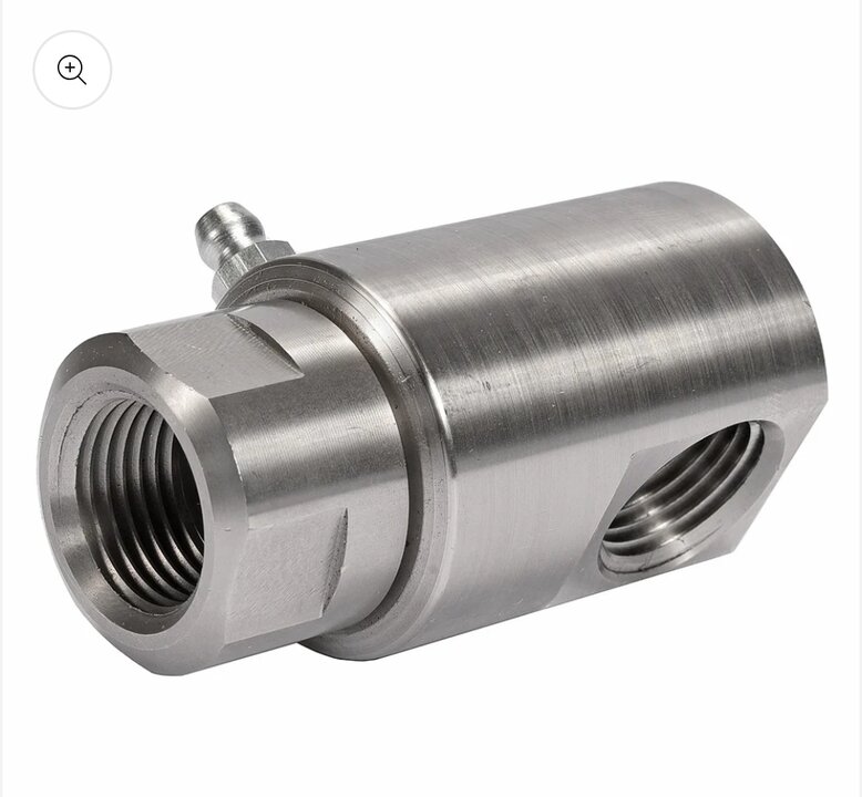

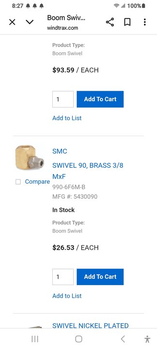

Dwain, I got a new live reel fitting for our garden hose. The old one was seized, the previous owner never greased it. $150 for the swivel fitting, man that's an expensive fitting. But it saves so much of a pain in the butt.
I also replaced all my high pressure lines with these, they seem really solid and are rated for 6000 psi. The smallest pressure lines are different just braided steel. The whole rig feels so much better now. Next up, new pressure pump!

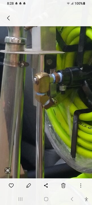

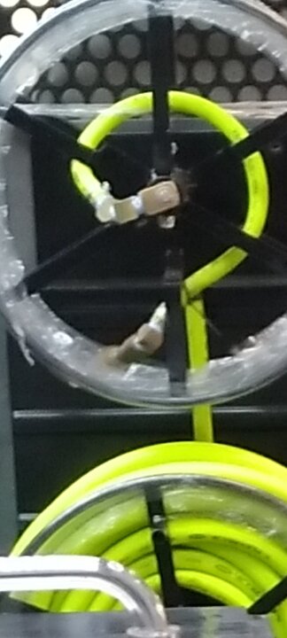

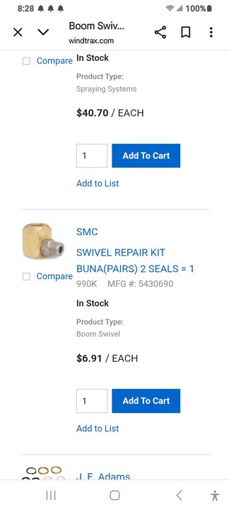

Thats real expensive for a live reel swivel. Thats about what i pay for a rx20 rotary swivel. These are what I've been useing on live reels for as long as i can remember. Every 2 or 3 years i put in a $7 seal kit. I just pop a spring clip off the end, pull the block off, remove & install 2 oring like seals a dab of parker lube oring stick it back on good for a couple more years. I get um from Windtrax car wash supply
Screenshot_20250903_082848_Gallery.jpg Screenshot_20250903_082742_Chrome.jpg Screenshot_20250903_082801_Chrome.jpg
Reactions: Bryce C

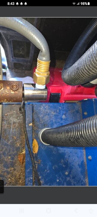

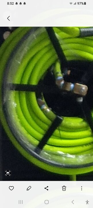

You should maybe put a 45°or2 to stop this hose from pinching . I put 2 so as to angle it properly then a short leader hose to a 3/8 qc then my hose has a standard male garden hose fitting to male 3/8 qc. Sorry for the picture quality, I'd taken more and better photos if i knew i was going to use um this way. Instead of expanding and screen shooting parts of the 700+ photos i have of the frankinstien build

That makes a whole lotta sense Dwain-o. I'll do that, thanks bud!

I used my Blue Baron heat exchanger for the first time today. The thermal relief valve is shot and my waste tank kept filling up. I'll clamp the rubber hose shut or install a brass plug for now until the new one shows up.
The heat is great, it takes a long time to make its way to my wand though. The system heats quickly when I fire up the tm and open the valve to allow hot coolant to flow into my hx. There is just a lot of cool water in the 150+ feet of solution line that needs to get out of the way. I suppose I should blow off a lot of water through a tool before I go in and start cleaning so I can utilize heat on my first wand passes...
The heating capacity is deep though. Seems like the more I pull on it the hotter everything gets. There is 80 feet of tubing in the Blue Baron hx, and I added about 4 gallons of engine coolant to install it ✨
