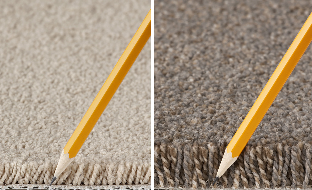

Thanks everyone for the comebacks, just a clarification here...Carpet isn't CGD, It's a decent grade commercial carpet, looks something like the carpet on the left in this photo. Other than the wear areas the extraction cleaning did a bang up job (per usual). ā˜ŗļø
