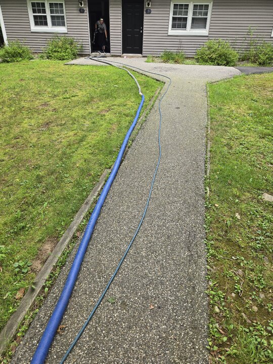

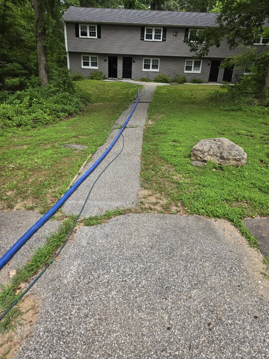

I never used yard sticks but have been known to slide the solution line down a 50 footer of vacuum hose for protection.
Works great here in the Northeast in the winter also.
