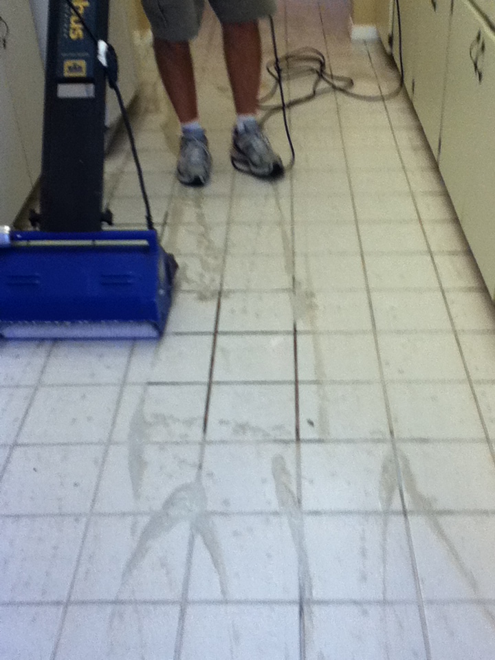

Looks great, Ross. This pic was CRB only? Being the hack that I am, I have to ask:
Is the spinner necessary after this?
Every job.
No such thing as a perfectly level floor, if you don't agitate you will get pooling and uneven coverage. Nothing worse than spinning and seeing that 6 inches of grout line you missed pre-spraying.
CRB usually more than good enough.
I don't know if the FB post is referring to Tilemaster? Tilemaster is a great cleaner, but you have to rinse like crazy. If not, you will get residue. The few callbacks that I have gotten after a tile cleaning have been because of this.
Save the blue brush and 175 for nasty restaurant stuff.

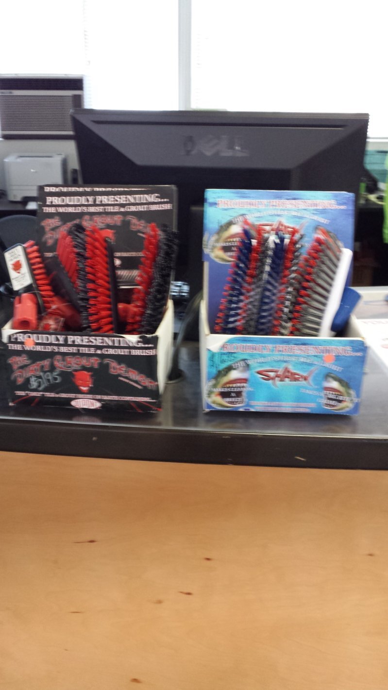

While the Interlink SS Grout brush can be overkill, and down right dangerous to delicate tiles, its A MUST HAVE if you consider yourself a professional hard surface cleaner...
Keep in mind you ARE REMOVING the top layer of grout so do so accordingly and evenly..

Mike do you use that brush to scour through wax or sealant, or just to break up impacted soil?
all of the above, but for normal soil it's usually overkill.
Agreed to all the above.
This little tool is one of those "Thank Goodness I have you today" type brushes!
Some terrible grease laden impacted garbage loaded Grout lines....just the tool I had been looking and hoping for....
I just got in 4 more of these brushes last week, just to make sure I have one stashed somewhere.

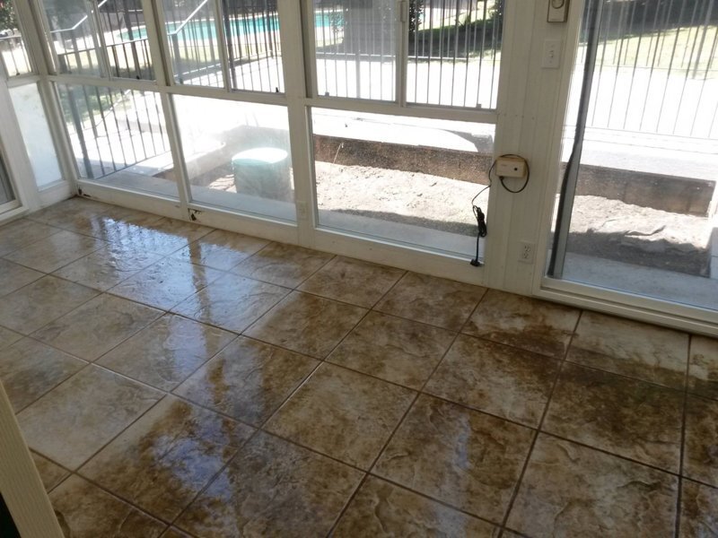

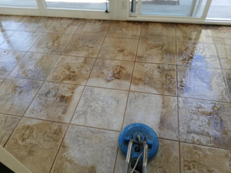

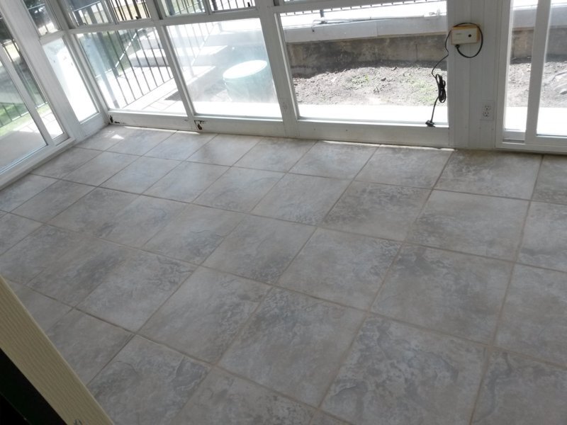

30 year old plus tile grout never cleaned professionally. Used "snake oil". Prespray dwell and set up. Tried using tile spinner alone. Oh I mixed it on the strong side too. Wasn't happy at the results. So redid it. This time scrubbed with crb and shark tool. It did clean up really good. But it needed scrubbing. Most of my tile jobs do. I used to use the 360i tile head which is a brush and does a good job because you're scrubbing as you're cleaning. But the crb/tile spinner is still faster and does a great job. I did just order a new cleaning chem to replace my snake oil. I think it'll be better we shall see. But I'm planning on still pre scrubbing my tile and grout.
