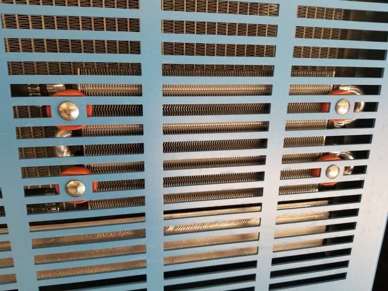

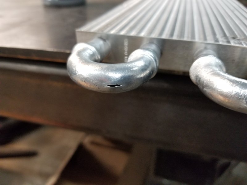

The new Sapphire 870 has a water cooler on the front of the radiator to control the temperature. Which may work in Arizona. What happens when you have to use it up north. What would Marty say? Ummmmmmmmmmmmmmmmmmmmmmmm Oh ya Idiots

I think that was put on the front to keep the water box cooler because of all the issues with the CAT thermal 165° valve. Am I wrong?

I have the older model also. The one in the picture is the newer model less than 100 hrs on the unit and has replaced the cooler three times. The last time was because it had froze and he admits that but the first two just ruptured and sprayed water all over the front panel. I really don't understand there thinking, when you are starting the unit up that is cold water in that cooler,and drawing cold air right through it. Those small tubes are going to freeze instantly and the carpet cleaner gets blamed. If the engineers aren't riding in the caboose their head probably is.

Engineering on many TM's is very poor for service.
They should be forced to remove & replace all the major components before releasing a new model.
Compact units are the worst. I feel for the mechanics
who have to contort their bodies to get to all the parts.
P.S. - Three coolers in 1st 100 hours would point to initial quality.
What else was damaged when the one cooler froze ?
