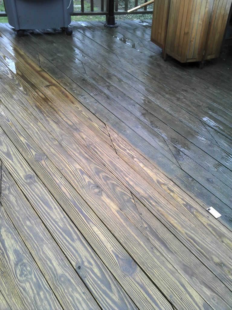

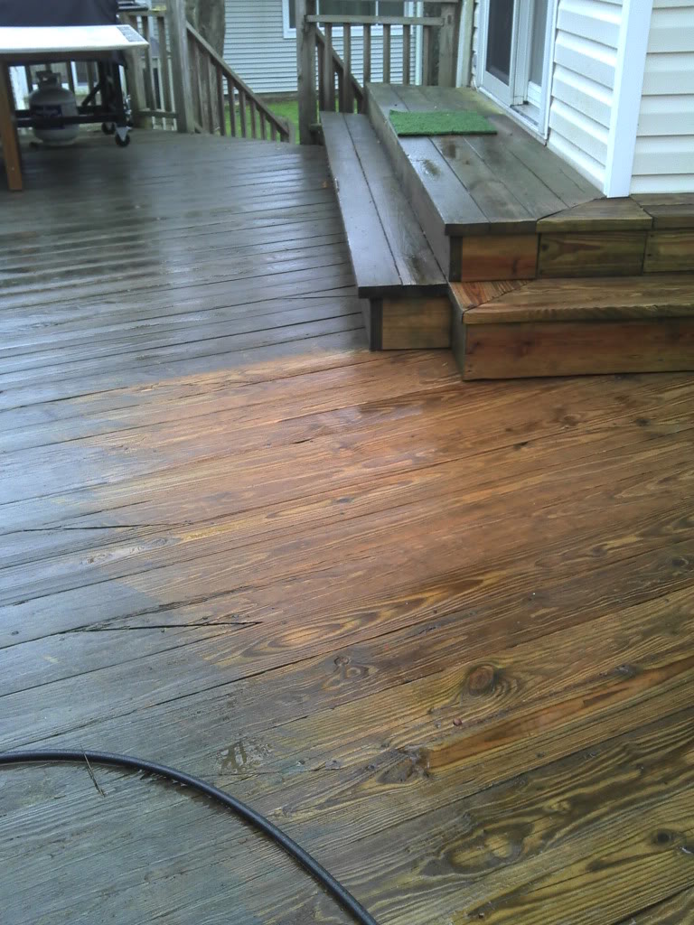

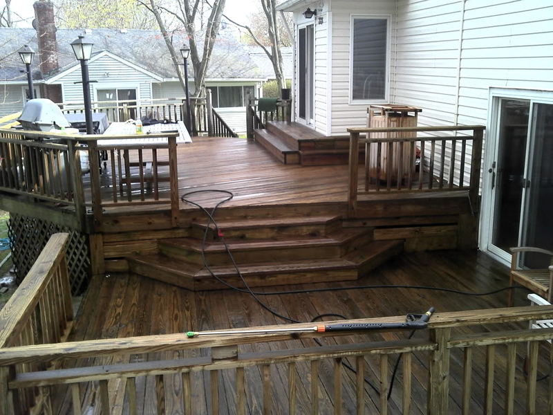

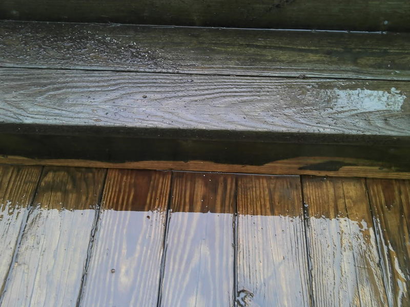

I have never used Restore-A-Deck. I think it's a mostly a sodium Precarb oxidizer for mold and mildew. I have used a similar SP products, but they have never seemed to make a difference, and I always resort to relying on pressure to peel shit off. There is a school of thought in PW that "Less pressure and the right chemicals" is the correct way to go, but I have yet to figure it out yet, and it usually means using LARGE amounts of chemicals and "Downstreaming" them.
Either way I think learning proper technique would be first and foremost to chems.
I enjoy doing decks, but they can be tedious, because sometimes EVERY side of EVERY component must be peeled, which can make things interesting as far as achieving all the right spray angles. The challenge with wood is to keep the lance tip moving at the right angle and distance. I prefer long "sweeping" passes. One place too long, at too close a range, will leave chop (lighter) marks all over the place, and possibly score the wood. I also like to trigger my gun a little further away from effective range, and slowly move closer.
Never underestimate the ability of high pressure water to Fook chit up. If used incorrectly, it will not only damage wood, but brick, stone, cement, stucco, and just about anything else. Don't ask me how I know..... :oops:
