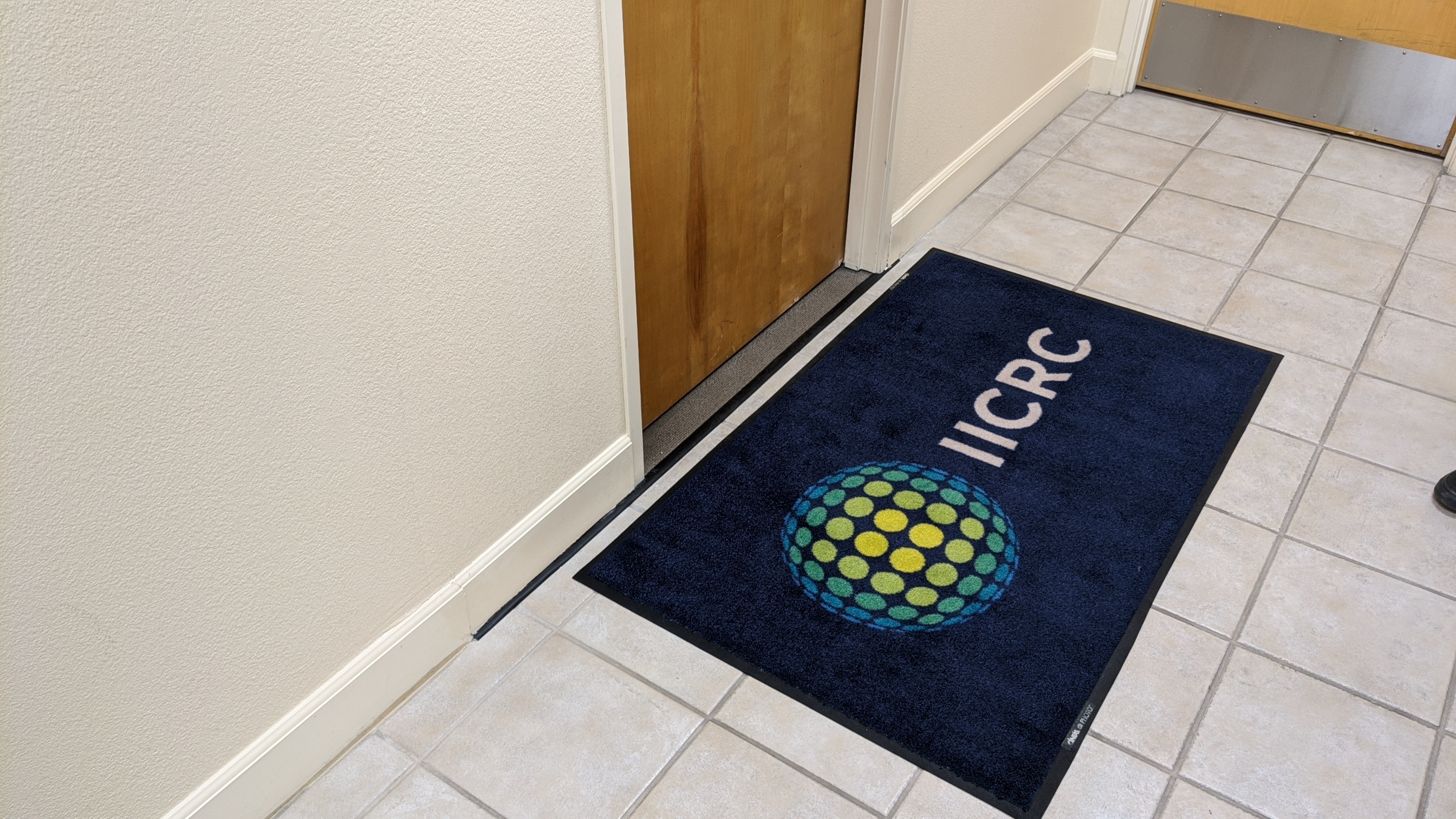

Count the blunders..
117,263
Brian H
Dec 14, 2006
3,776
Brian H
They built the doorway over top the carpet and never removed the transition piece under the new wall.
And, the rug isn't centered in the doorway.
And the grout is filthy!!
The Great Oz
5,295
bryan
They scabbed in molding bits.
The wallboard doesn't look like it was taped properly.
The vertical door trim is not deep enough to cover the ends of the base, or the base used in the building is too thick.
I don't know if the grout is dirty or just Stanley-quality color seal.
Reactions: Mike Pailliotet
117,263
2" inch section of baseboard on the right side, at 80 cents a foot, cut a new full width piece, Tony....
oh and the orange line is where the carpet and trim should end.

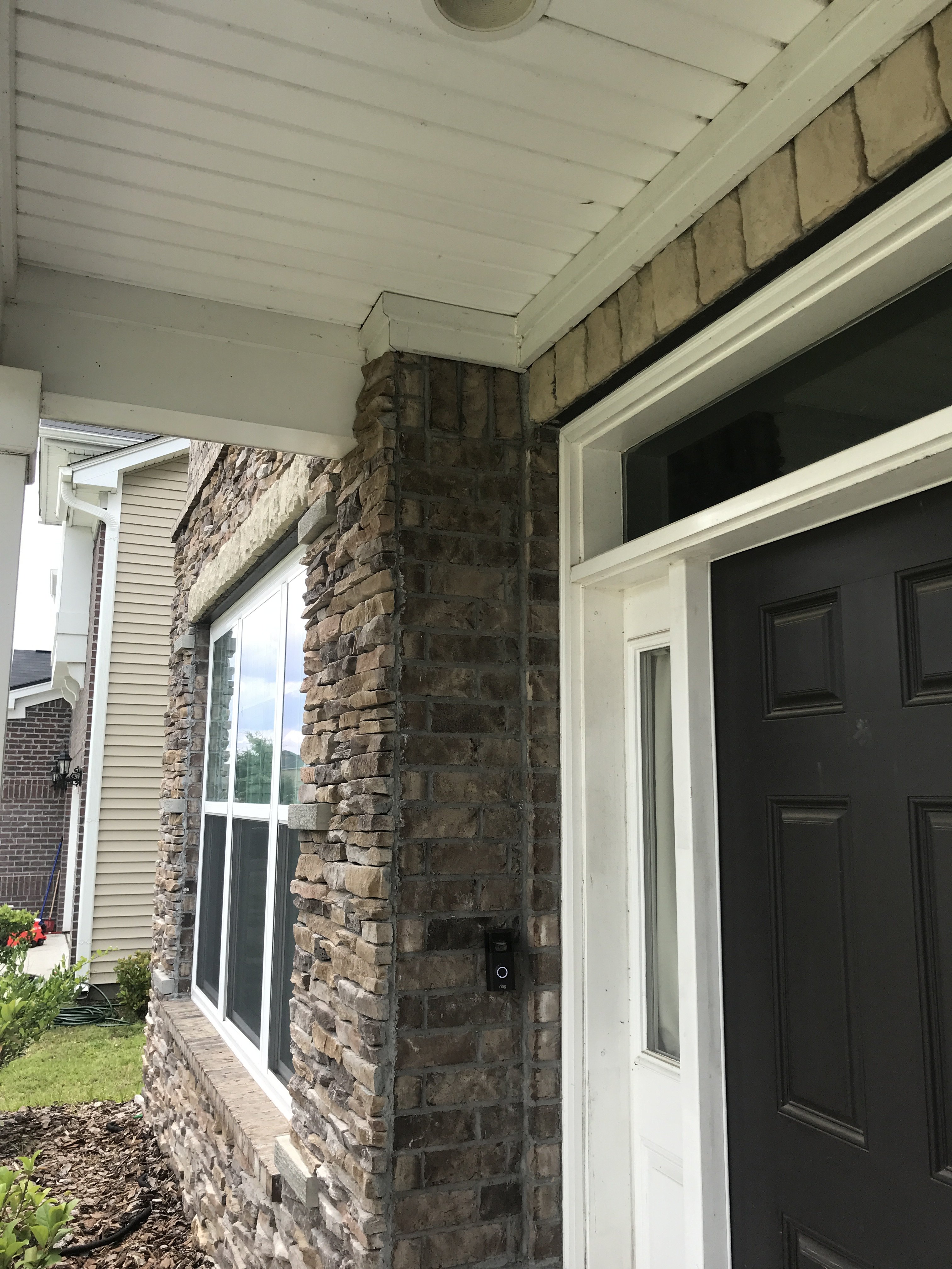

Look also at the face stone on the first floor. It was just stuck right on top of existing brick.
