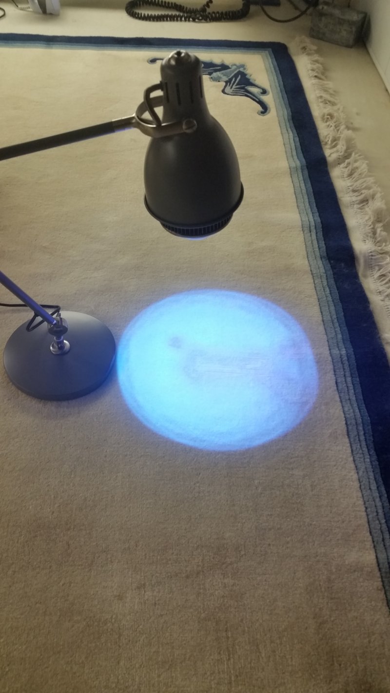

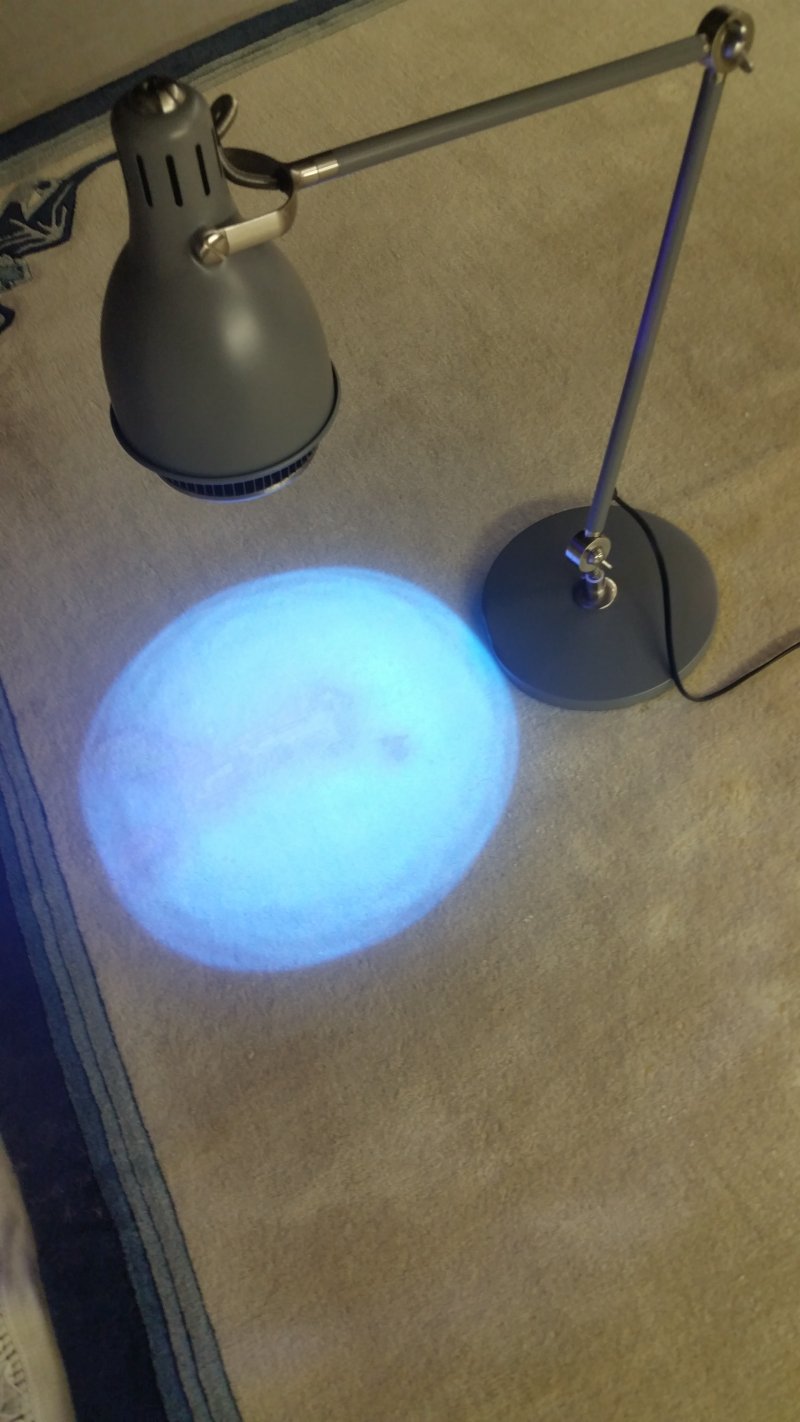

Yellow stains of unknown origin continued to exist even after two washes and a series of H2O2 treatments. The light is now being put to the test.

Tom, do you also have a before picture?

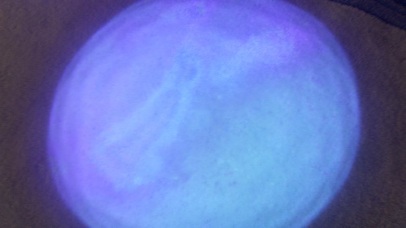

14,644
So how are they different?- both seemed the same to me.
I don't have a picture on hand, but an untreated spot will show a light yellowish/greenish reflection. And the treated spots will be a white/purplish reflection.

Ron; Here are the spotting instructions for our UV stain removal:
"These are concentrations of Dynachem Brightener (15% peroxide +penetrant) used for spotting operations for removing water marks, some disperse dyes , or yellow stains.
Concentrations of peroxide used are 7.5% to 15%.
It is done ideally at warm temperatures and pH of ~9.
Use the Brightener from [50% to full strength],
& raise the pH of the mix with DC Shampoo (foaming agent) at 1 oz/quart.
It should begin to foam quickly.
Brush the foaming mixture lightly onto the stain surface with a paint brush.
Apply the UV light to the stain for 10-30 minutes.
Check for removal of stain, & rinse with cold water if satisfied. "
