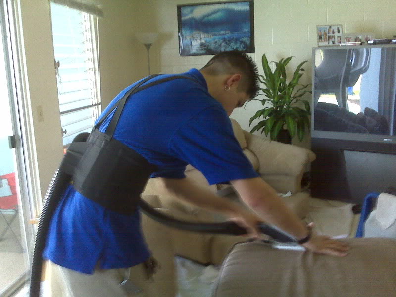

Take it outside .. pour degreaser all over it and then pressure wash it ..
Microfiber is usually loaded with oil .. so use something that will break it down .. brush it in .. using a drimaster type tool would be best to extract .. then brush the lines out

I use this on micro fiber all the time and it works great....I use a internal jet UPH tool..
It is really pretty easy to clean.. spray on..scrub in and give it hell....it is the drying that really makes the difference....set up a blower get a horse hair brush or a dry towel..which ever works best for you and give it a nice appearance...

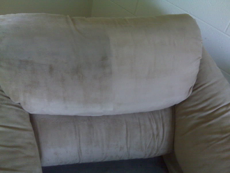

microfiber is synthetic and usually solid color equals a good strong prespray, aggitate with a horse hair brush, extract with an upholstery tool, brush with a carding brush, collect check and walk away

We use Ultra Dry sprayed on and scrub it in, then fresh propane heated water rinse it. Never did have a problem in over 13yrs using that process.

I love microfiber. It always cleans up great for me. Cleaned one the other day that a kid had done allot of artwork on with a black marker. It looked like new when I was done. I use the Prochem tool and the mist and vac method for areas that do not need much cleaning. Microfiber that has been treated with protector sheds water, so you may want to take a towel if you are working on a hard surface floor. I will take Microfiber over light color cotton any day. No bleeding no browning. Make sure you groom the fiber with a towel or brush before it dries.
DON’T FORGET TO BRING A TOWEL!
You guys want to get high?
116,049
Drimasters are horrible on Micro fiber/ultra suede.
The vac port locks down and the spray shoots all over.
Pro Chem tool w/ Gglide is the way to go.
Feb 26, 2008
237
I agree, drimasters are terrible on microfiber. It's like taking a shower. I break out the trusty ol' hydry and let 'er rip.
Spurling
Sep 23, 2007
361
If you keep the fabric tight with one hand .. using the drymaster is the perfect tool .. no overspray, running water or dripping.
