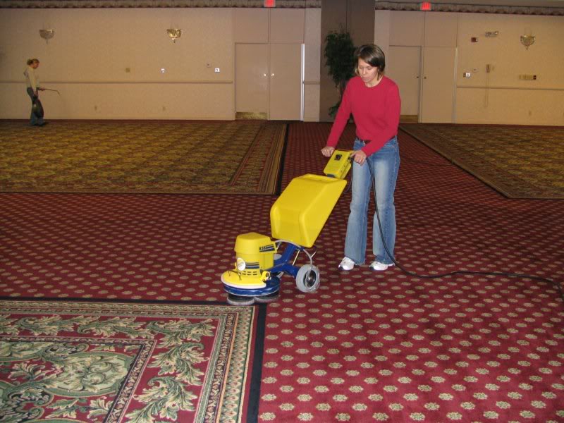

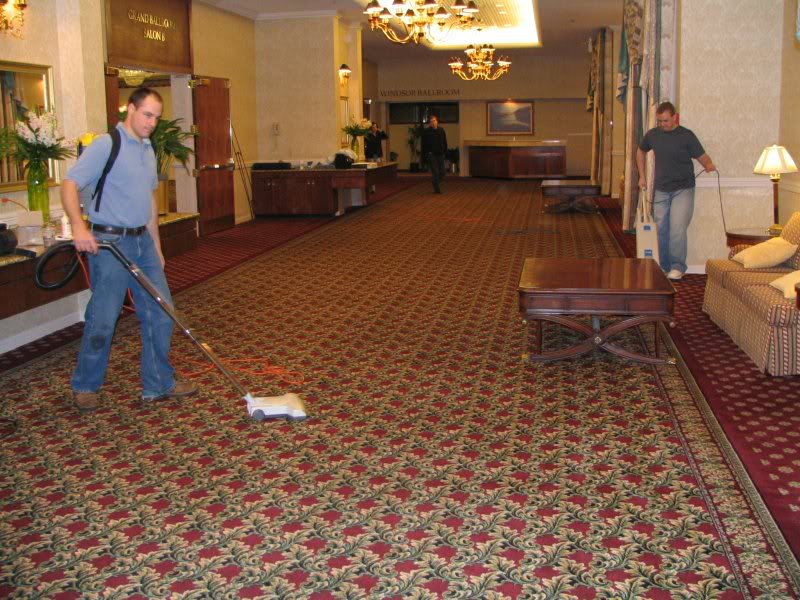

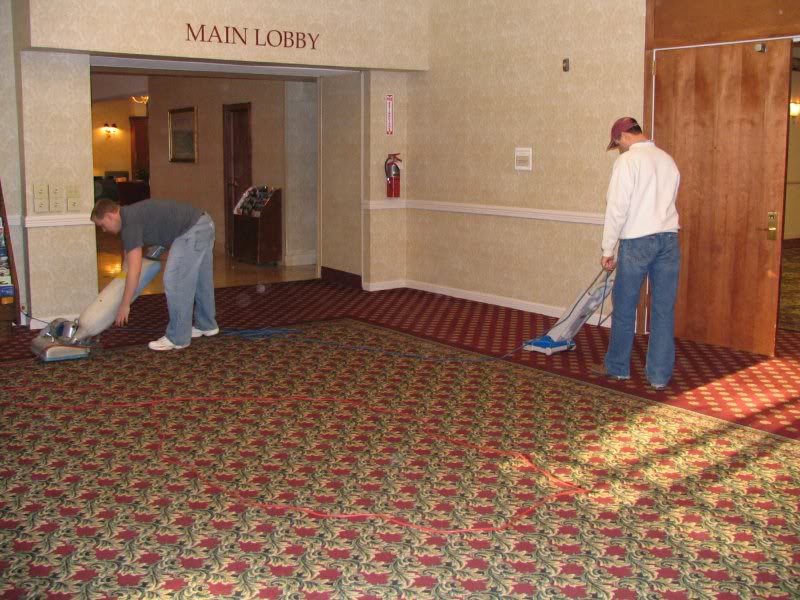

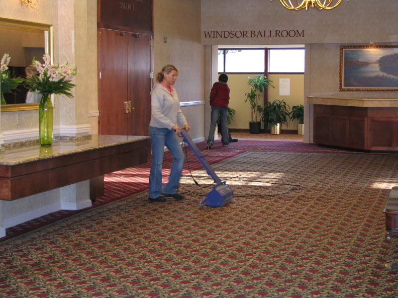

Here area a few pictures to show the pilebrushing followed by vacuum before encap; then encap; then post vac. So easy even girls can do this work! (just kidding, just a joke)

Jimmy that was my first thought as well, Where's the uniforms?
They look like a good cleaning crew and have the right equipment but they are leaving out a very important step in how they project their company image.
It looks like they are in a nice hotel and who knows what new contacts can be made there. I so surprised that there are so many companies out there that are leaving out the basic steps on making their company shine and look professional.
