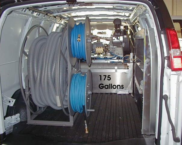

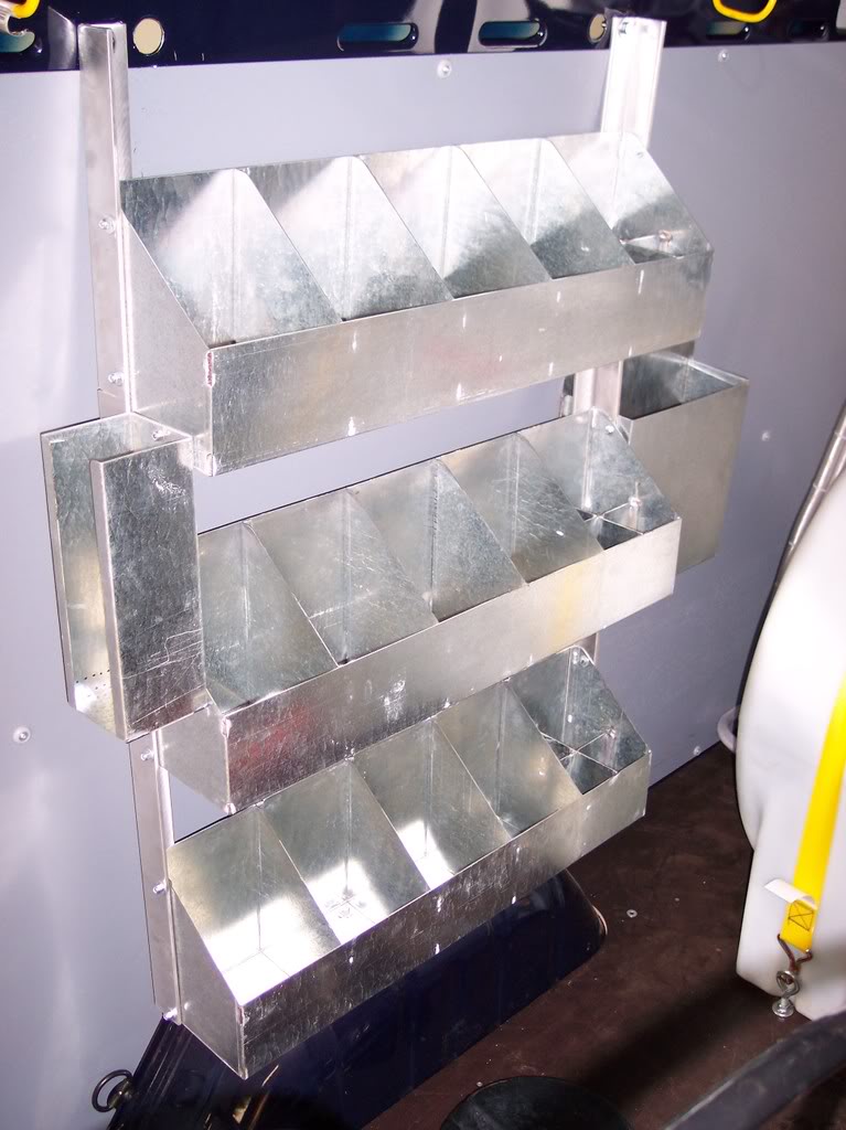

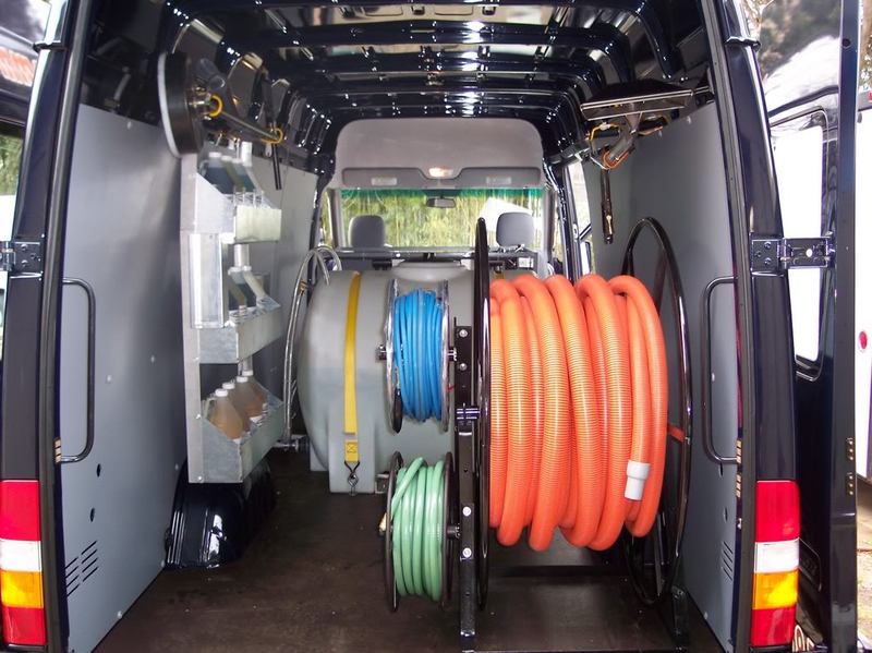

We like the stainless shelves also. They take up less room than wood types.
Here is a photo of the stainless one installed on the right side of a GM van:

whiskers looks nice , i like the stainless ones but why in hell do they need to cost that much its like a gallon of gas just no justification in being that pricey.

Why in the hell would someone build a chem shelf out of steel, Anodized alum. or stainless is all that belongs in a TM.
well done Wiskers.
some of the "home made" shelving i've seen looks pretty poor.
Your's looks clean and professional.

does any one know the thickness of the metal shelves. i have some sheet metal that i might just go and find a sheet metal break and shear and just make my own i need dimensions too if any one could get them for me that would be great but i need to know how thick they are i might have to thin of sheets they are galvanizied so i will have to paint them up real good then line them.

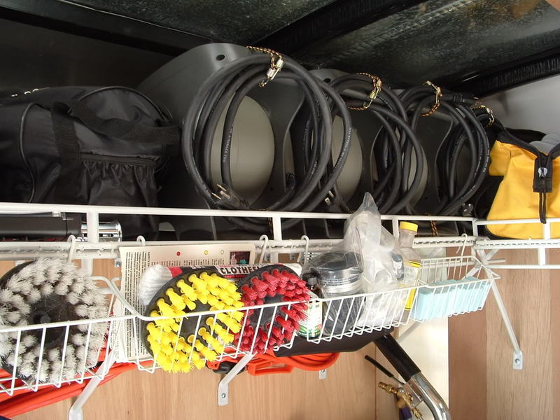

Air King Rack on Driver's Side- Wire Shelves from Home Depot

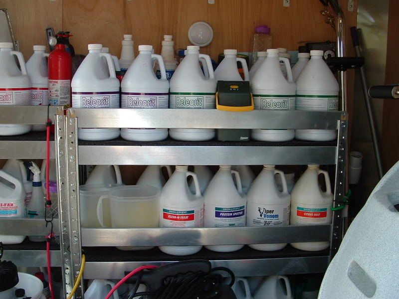

Chemical Shelves- Wal-Mart, Particle Boards Coated HEAVILY with Herculiner from Pep Boys

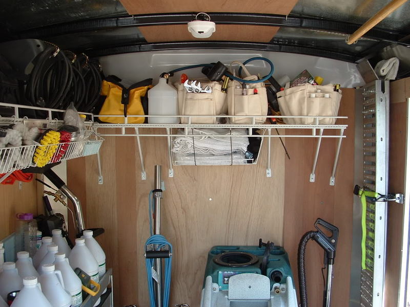

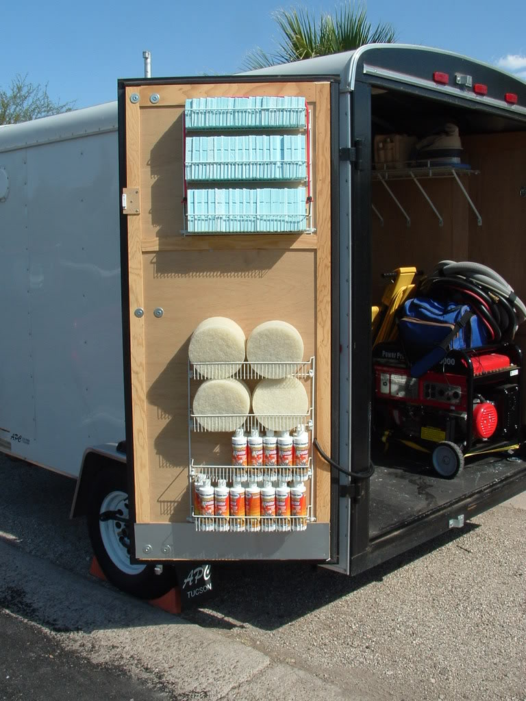

Inside Driver's Side Door- Wire Shelves From Home Depot
Front Rack- Wire Shelves From Home Depot

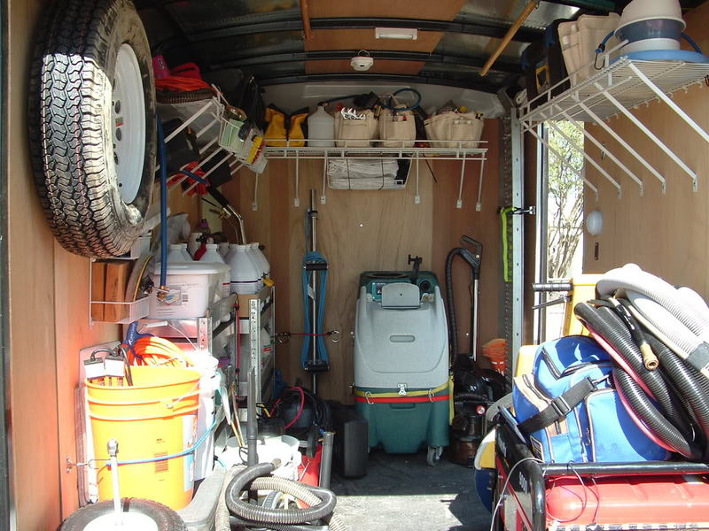

Inside Trailer From Back Door

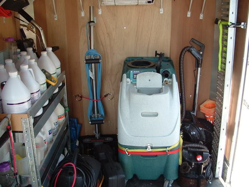

Front of Trailer- Olympus M200H Portable, Checmicals Shelves on Driver's Side
Greenie
6,820
Del, you run that Olympus on the GenSet from the trailer?
I don't see any 2" hose?
I do see an AMF wand and Rotovac. :)

I am running 1 1/2 hose. With the Rotovac being 1 1/2 would I get any benefit out of going 2 inch?
I run from the generator only as a last resort. Some properties with no power, I got a good deal on the generator so I figured I can work just about anywhere I needed that way.

Oh yeah, and no I don't run it from that trailer off the gen. I run the cords into the house.
Never tried more then 25 feet of 1 1/2 hose, just don't think it has the guts for it.

Is that a power pro generator from pep boys? i have the 3500 watt version and it is more reliable and easier to start than my honda powered 5000 watter

Man I love see everybodys different setups it always seems like you see something done that is better than your I think everybody should post a pic of there set up. And dangit Les I now need one of those second hose reels for my hose reel set up all I have is the single solution hose reel. Is any body doing anything with the area between the two front seats? I love to be organized I just cant seem to get there yet and need some help in the front of my truck too.

Swap out the 1.5" waste tank barb with a 2" and threaded 2" PVC elbow and report back, it's not too hard, just need a 2 3/8" hole saw and a steady hand, maybe $15 in parts, Then pick up 50' of 2" hose, it may very well be money in the bank for you in time savings of leaving the machine on the front porch for filling and dumping and keeping noice outside as well as humidity.

Yes it is Anthony. It does not get many hours on it, but it starts and runs like a champ when needed. And for the power output it was a SMOKING deal compared to other brands.

Re: Chemical Shelves HEY DEL
you doubled up those shelves didnt you???
cuz i have looked from here to hell and back and cant find them with the lip UP....I looked at yours closer, and you have 2 sets, 1 regular, and the other flipped upside down huh???
DAMN why couldnt you tell me this earlier????? wasted oodles of time looking for this :x :x :x
DRScrivner
Apr 20, 2007
385
Are you referring to mine Doug?
If so yes they are the same brand but two different depths - AND - one was originally a four shelf unit and the other a five shelf unit, but I used some of the supports as the fronts to keep jugs on the shelf, so each is only 3 shelves high.
