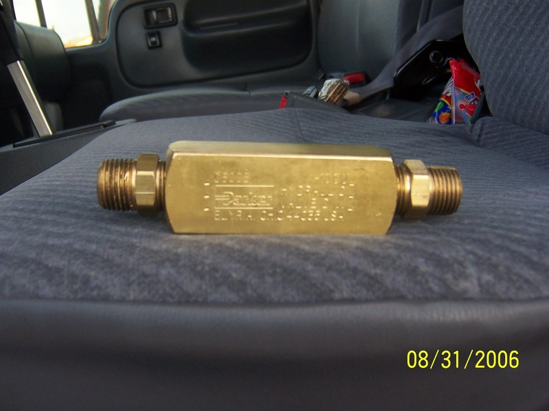

Chem meter is rising when off the trigger
J
JS41035
Diaphragm. That's why that ball valve on the 870 and 2500 are nice. Order 2 when you get them. Because as much HP stuff as you do you'll need it. Out to be a 10 buck fix

On the Butler it can be the Chem injection pump diaphragm with a bit of wear or hole but I have also found the pressure regulator can cause this trouble too

@dealtimeman knows the answer.
Actually he had to call me to get the answer because he did not even know there was a check valve there....
If you get this one from windtrax......you will never ever have to worry about it again...thats what I put on mine...

As soon as I saw the diagram I recalled that part and its function. I had that one you got...
It failed too..
