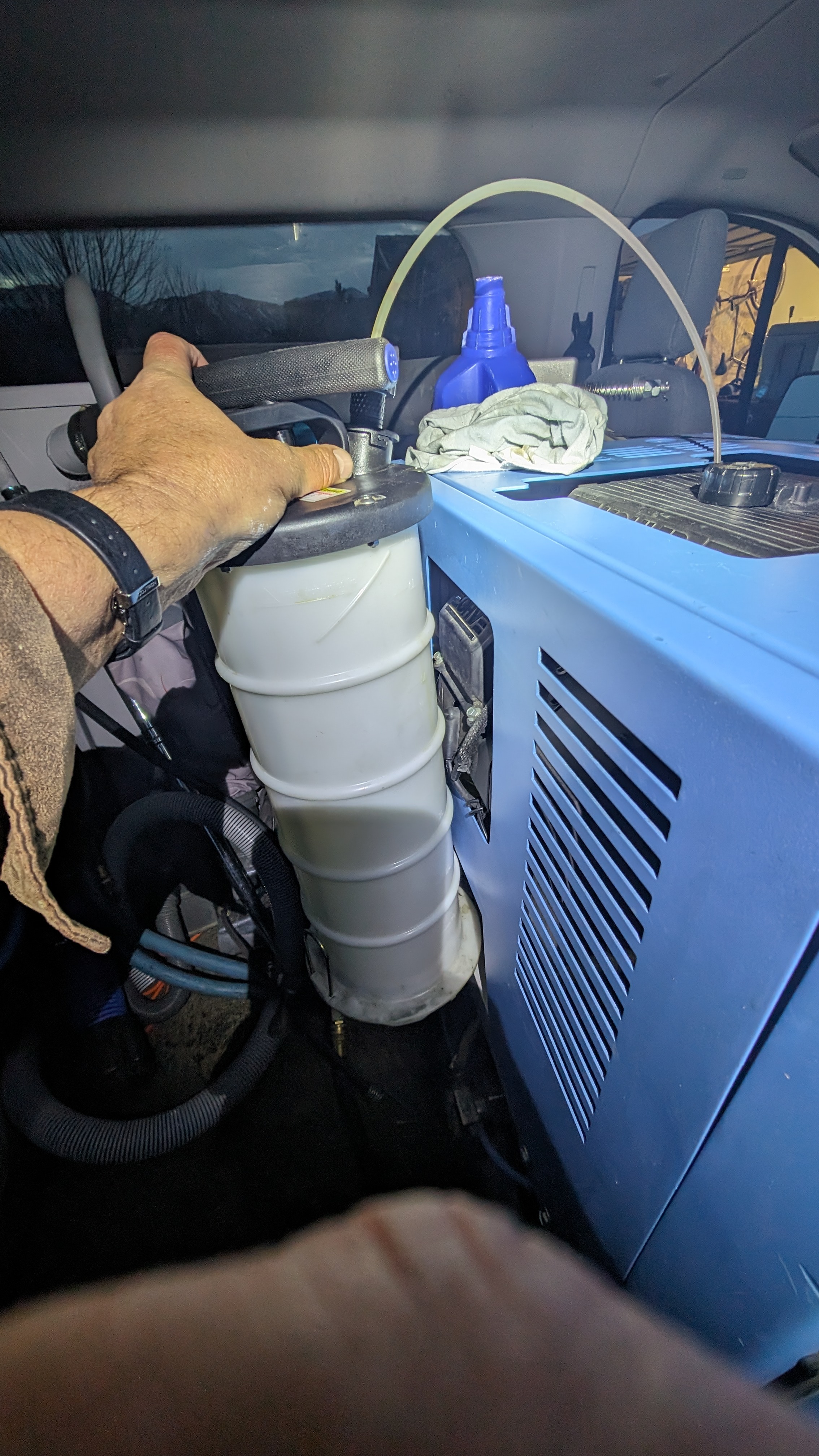

We did use an air compressed tool to help remove as much as possible and I believe the TM mechanics would do no different. I'm not running this at load or on a job yet& If I do this over again to clear doubt I should probably park on a hill like I do when I change engine oil 🤔

The exchange rate here of old Aeon oil vs New Aeon oil doesn't inspire confidence. Here we are as glorified vac cleaners and there's no vac attachment to extract...
