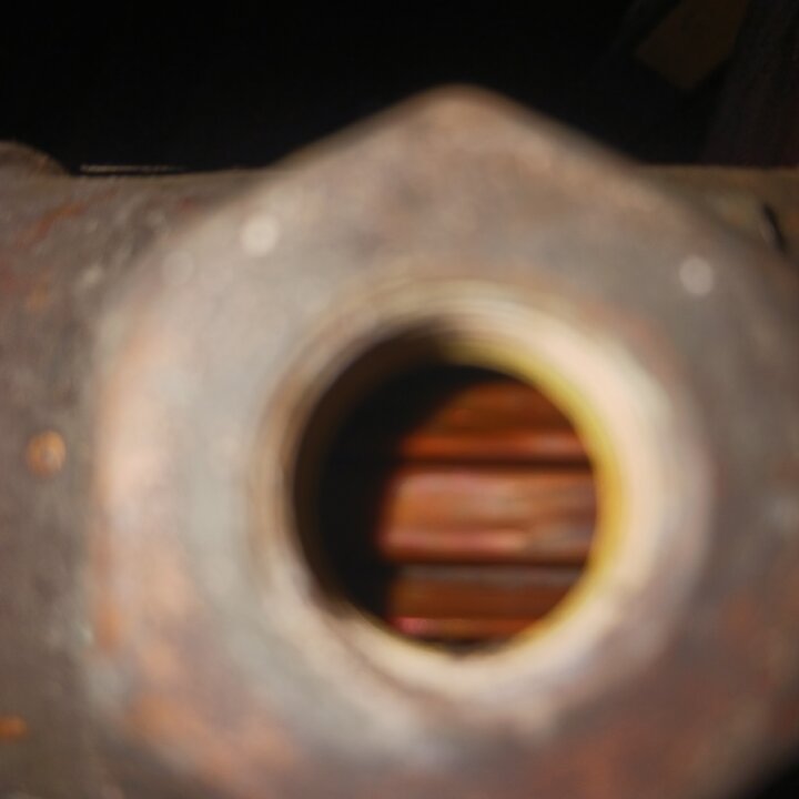

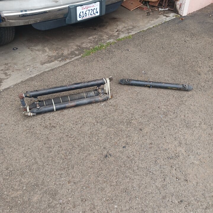

You're being very helpful. In one sense I already knew what was going on when the bolts were spinning in place, but on the other hand I refused to believe they just thread the bolts through the metal waste tank at the factory rather than welding a nut on the inside or something. And all 4 bolts just spinning in place seems too stupid to be real, so I figured it must be me. But it's pretty simple and I'm looking right at it. Maybe I'm just whining...
Dwain Ray
Jul 22, 2020
473
First of all i believe your wastetank is aluminum so if they welded bolts or nuts they would have to be aluminum and even if the tank were stainless or just steel what if you stripped the threads or worse broke one off ?? Trust me you'd be bitching more about that than a bolt spinning in the tank

Forgive my pace of comprehension here but, how are stripped threads or a snapped bolt any worse in this instance than a bolt that is now just spinning freely? These bolts that are now just spinning freely are slightly loosened, so I'm a bit screwed as they will not be sealed anymore and water will just come leaking out around them it seems. And if the only solution is to cut the heads of the bolts off then drill out the shaft, how could that be better or worse? Seems like all those scenarios put me in the pretty much the same dung pile... maybe I am missing something?
By the way if I cut em and drill em out. Could I just get some rubber washers and a lock nut and bolt the new heat exchanger on in the future? I suppose there are a few ways to do it. I just want to keep it simple and not think about it for at least 5 years after I fix it. One can hope.

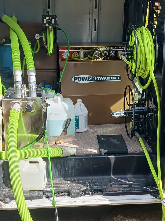

Im sorry i don't mean to pick on you. I have a hard time sometimes realizing that others are not as mechanically inclined or as well equipped to do the repairs as myself. So some things i find simple and common sense can be more complex to others. So if i get a little smart ass in my answers please don't get offended im really trying to help the best i can. The pictures below are of my personal repair facility i not only service and repair everything i own, i also have designed and fabricated my own equipment
20170328_215327 (1).jpg IMG_20161113_154756631 (1).jpg 20201101_082403.jpg 20250119_140446.jpg 20250524_133823.jpg 20250119_140822.jpg 20250524_133808.jpg 20250524_133814.jpg 20250119_140715.jpg

I'll cut the bolt heads to get the heat exchanger off tomorrow afternoon. And I'll pick up some plugs at a hardware store to plug the coolant lines for now. Ordering a couple pressure regulators tonight. Hopefully when they come in I can install one and start using this thing while I figure out the heat problem.

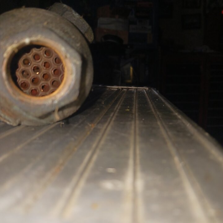

Thanks Dwain. I thought it was going to $1500 or more. $900 would be a relief to me. I'll get on it. And hopefully tomorrow the 4 bolts holding the exchanger on behave differently.
I just had a thought, Blue Baron used to and maybe still does make an all stainless heat exchanger for hydramaster ptos. Is was touted as higher quality and much higher pressure rated than the copper ones . From what I've heard i myself wouldn't buy a machine from this company ive heard alot of complaints about him but i have heard that they do make a great heat exchanger that will retro fit a hydramaster pto and its rated at 3500psi where as the copper ones are only 900psi but i personally won't run um above 500 and i have 4 bad ones setting on my shop floor because o went a little higher. Might ask around on this and other fourms if your interested and see if you can a few people that has um and see what they say. There's also a bunch of YouTube videos on there heat exchangers

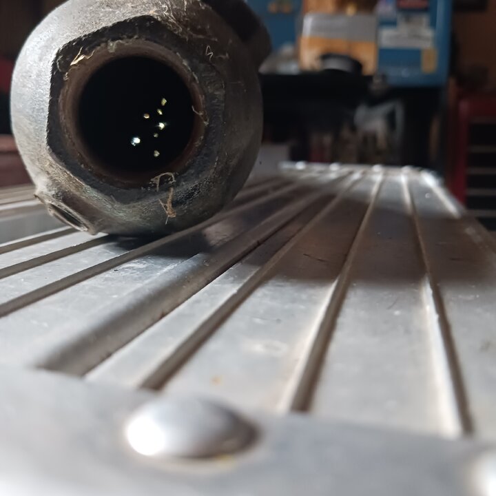

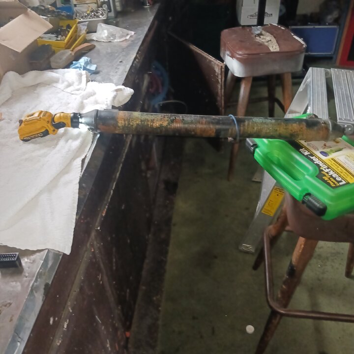

Thanks guys. I'll read more about them and then call these folks once I get my heat exchanger off the waste tank so I can look at it the way Dwain showed me. I have a feeling the small fresh water tubes are crushed. The previous owner of this tm had the coolant still hooked up but all the fresh water lines removed and bypassed from the heat exchanger, probably no flow.
I like the idea of stainless steel small tubing inside with a much higher psi rating! Hopefully the mounting bolt locations are or can be made on these upgraded heat exchangers in such a way that they line up with the stock CDS heat exchanger, so I can bolt it in the same location to the waste tank.
