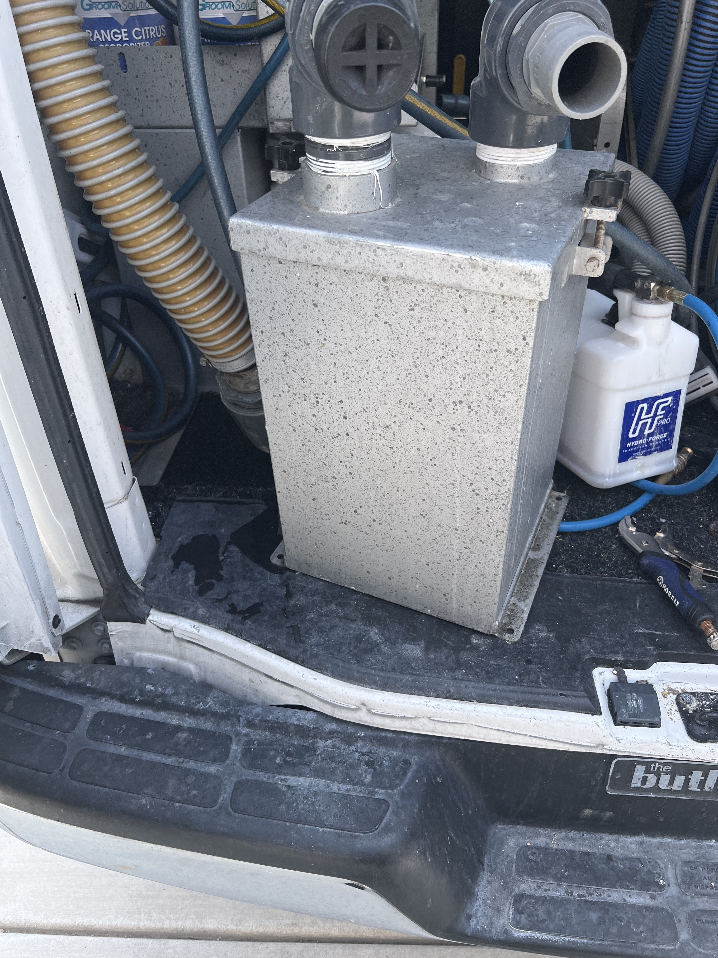

I bought a butler and so far has been great but on large jobs my tech is telling me the filter box is filling with water and he is loosing suction? I’m gonna be working on it tonight any help would be great!

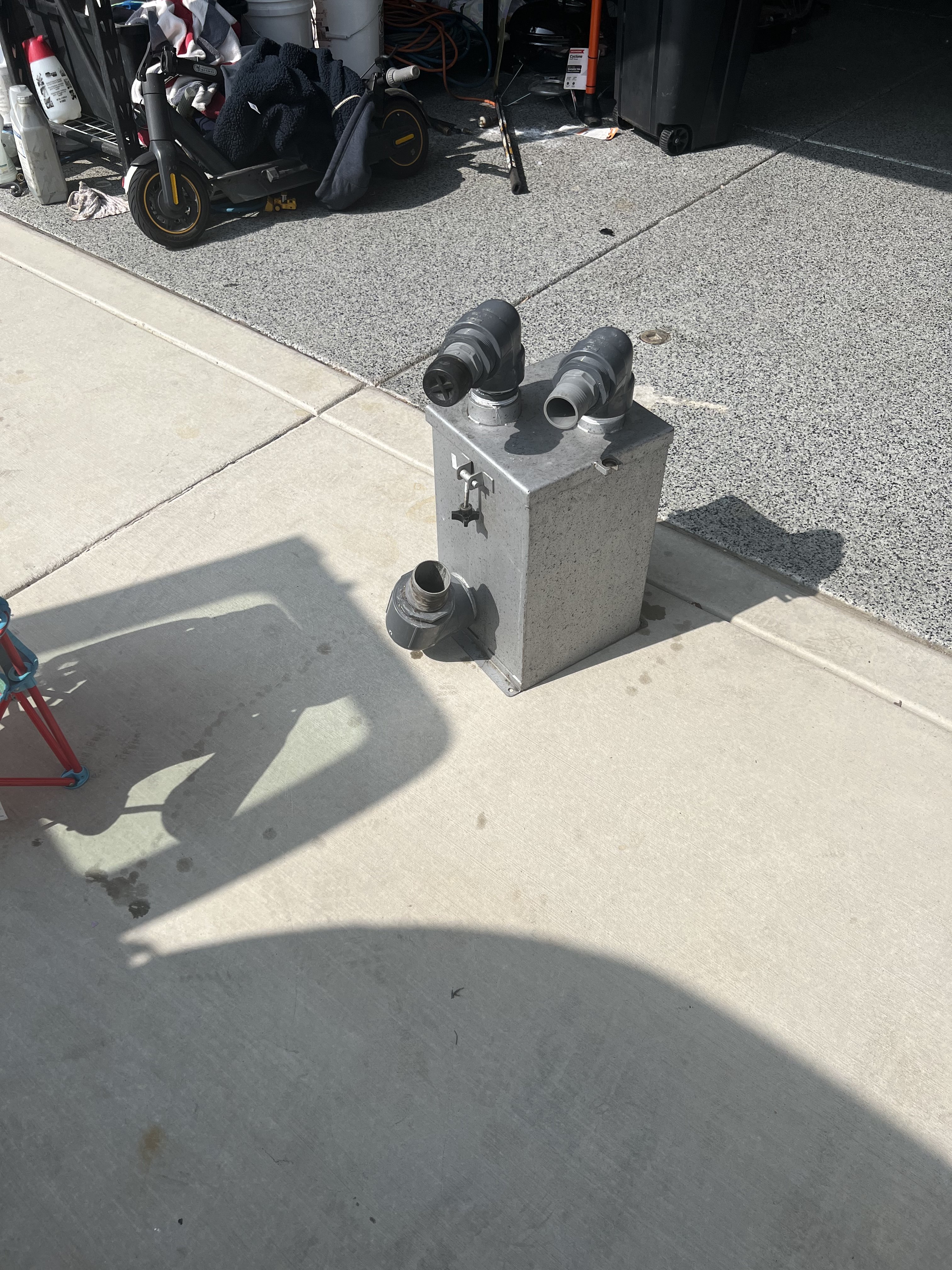

Well the clog was in between my employees ears he was removing the sock filter and emptying it but not spraying it out… it was covered in dirt and sand and couldn’t breathe I took out the box and cleaned everything out and showed him what to do…

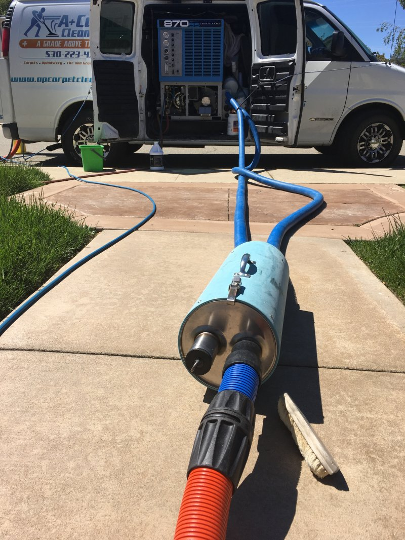

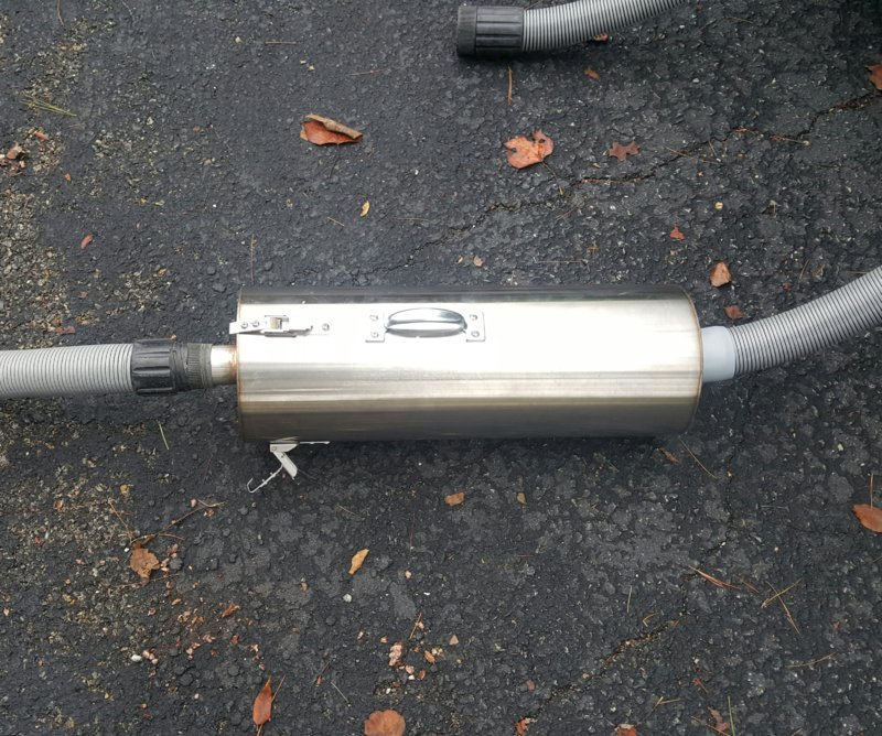

i'm talking about one of these, Jay

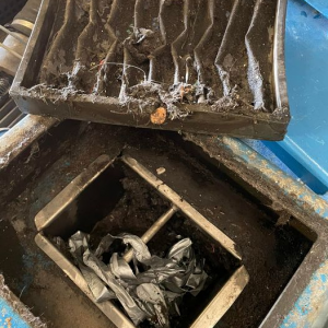

This is my in-tank filter that fits into the top of my waste tank. You can see the aluminium frame that the paint filter attaches to. All kinds of breathing room for the blower with this set up.
The filter can be washed down mid job if needed.
