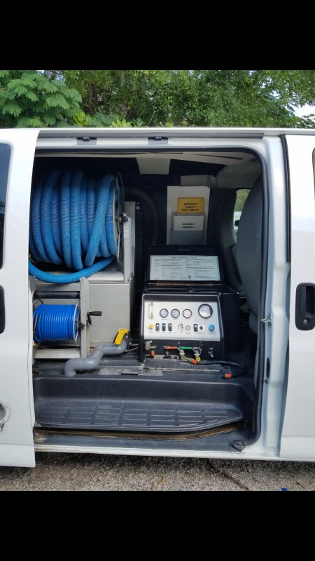

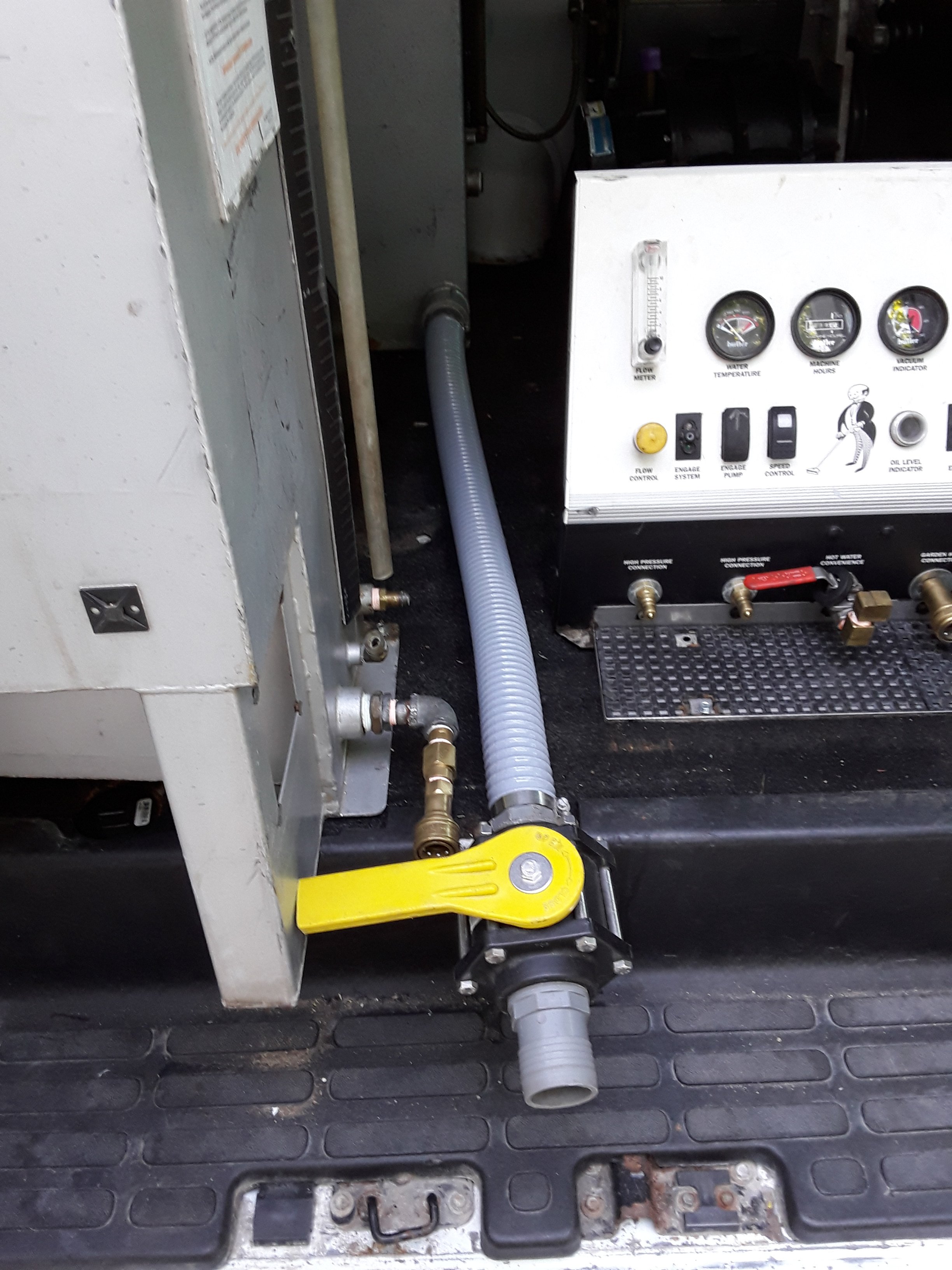

Dumb Larry......my filter was IN the tank and you jus reached in and pullt it out OR...
Jus hose it off inside the tank
The blowers filter is in the tank, I think these guys are referring to an in line filter to catch debris instead of bunging up the tank drains. The Genie tank that is in Unca Ernie has the ss filter inside and is susceptible to ingesting water into the blower. A better design is employed on other tanks where the ss filter is above the waterline and is almost impossible to sucked dirty water into the blower.
