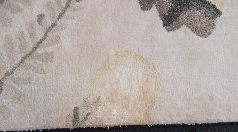

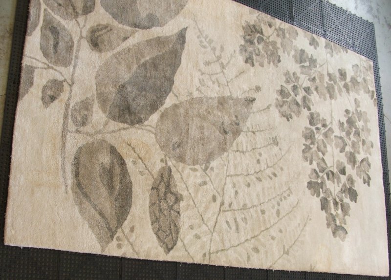

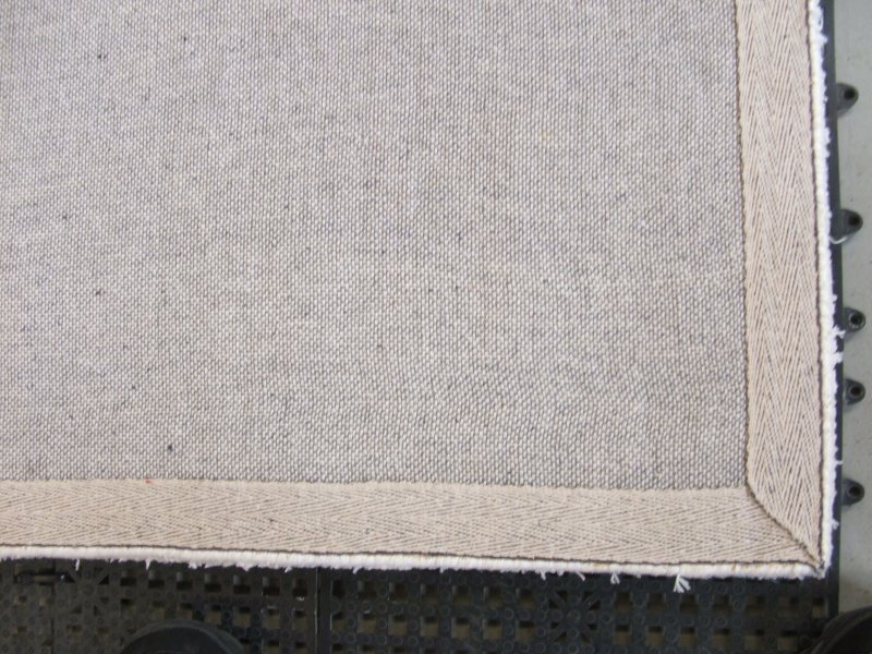

According to label 100% viscose - made in India - hand tufted enclosed pic of full rug , backing and heaviest stain. Think staining is accentuated by fibre distortion as intensity changes dramatically depending on view angle.

The distortion or color Hue change based on which direction its viewed from is a natural characteristic of viscose.
When using sodium meta-bisulfate to correct the browning of the face fiber it can trigger the latex to cause browning on those types of rugs if the latex get too wet.
As for the staining it looks like pet/urine stains. I'd Pre-spray it with CTI last step or urine pretreatment and flush it really well.-- but I'd first - inform the customer of all the problems with such a rug and that she should have lowed expectations and get a signed waiver.

OK, two "browning issues here. First is the rayon itself, which can be handled with an overall thorough cleaning and speed drying. The second and more difficult is the adhesive residue that wicks up from the foundation. This happens with all cotton tufted rugs and can be removed with some small difficulty by using solvent. Adhesive wicking is much worse with rayon, and more difficult to remove.
