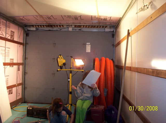

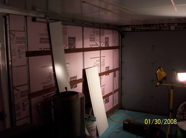

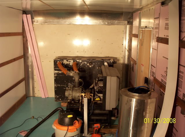

WHAT!!!!!!!!! a light bulb???? i doubt it....
the process of insulating
did the ceiling....this summer going to somehow finish up the front part (no framing to put insulation panels in)
then put the ole space heater in
the truck is usually nice and toasty...nothing frozen yet..though i do sometimes worry about stuff on the floor...

the pic in floor guys van has his blower teed off to the tank. is this the same as going to a 2.5 or 3 inch off the blower? i hava a #4.would it help me any with a 20h onan?
floorguy
Nov 7, 2006
6,948
Utah
Doug
The main reason i do that is because the tank ports are only 2"...so why would i want to choke off my vac with in 2'???
so i take the full 2.5" Y it into 2 2"...then off the tank i have 2 2" into a 2.5 Y...and run 2.5 the 1st 50-100'
Is your systm getting choked right away???
then yes it will help
