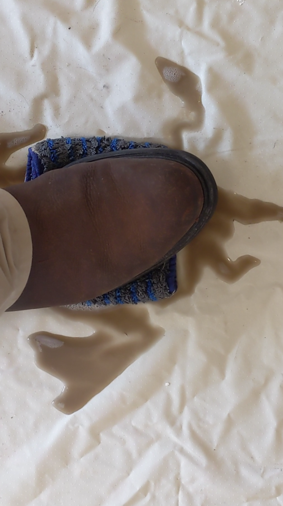

The fiber pad was used on VCT. Held together fine. The blue star-sewn pad tore all to h*ll on LVP. It was brand new like the two clean ones.
The circle-sewn striped scrub strip pad sailed through the remainder of the LVP with NO damage to the pad. I washed it and used it to do our bedrooms today.
@encapman do you have any more of these tough guys? Does the sewing pattern affect the durability?
BTW the soil those things absorb is unreal. I had to rinse and wring frequently and the water looked like driveway sealer.
