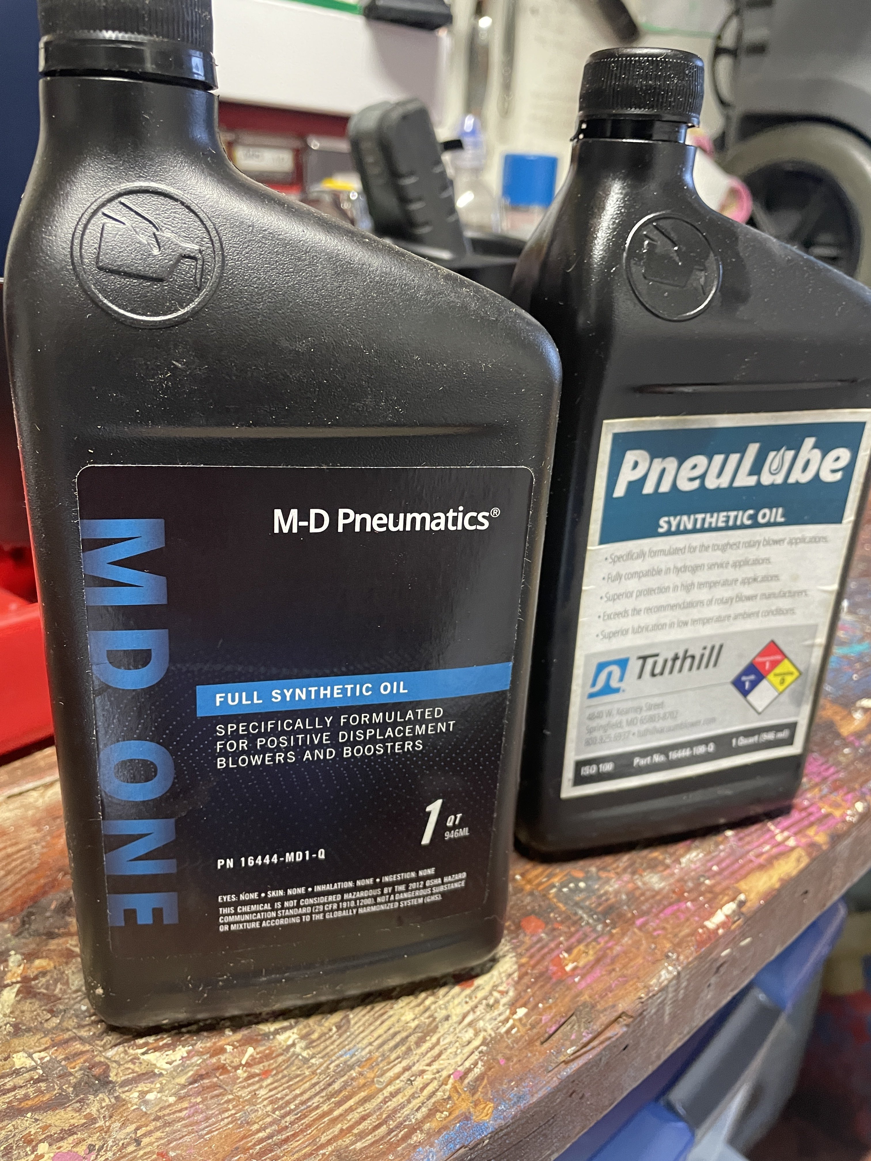

Would it be ok to switch from the tuthill oil to the MD One? Routine blower oil change. Just for the fact I have enough of the MD One to change it.

I don't think it's a problem, but to air on the safe side i wouldn't mix um together, i use areon and not familiar with these brands. Is there any ratings or specs on the labels like motor oil? With Motor oils it is acceptable to mix different brands as long as they're the same type ie: synthetic mix with synthetic although I personally don't do it. I do put cat oil in my hypro pump . Because it's readily available at home depot
