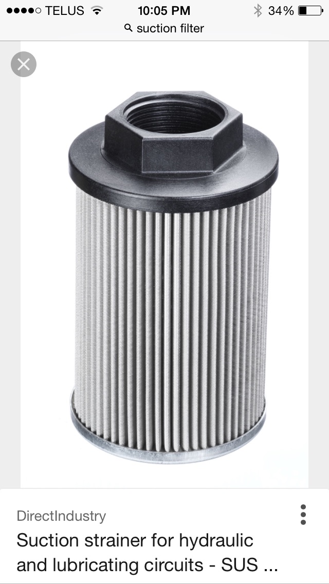

No. Filters are sized to not reduce airflow, yet protect the blower from particles that would damage it.

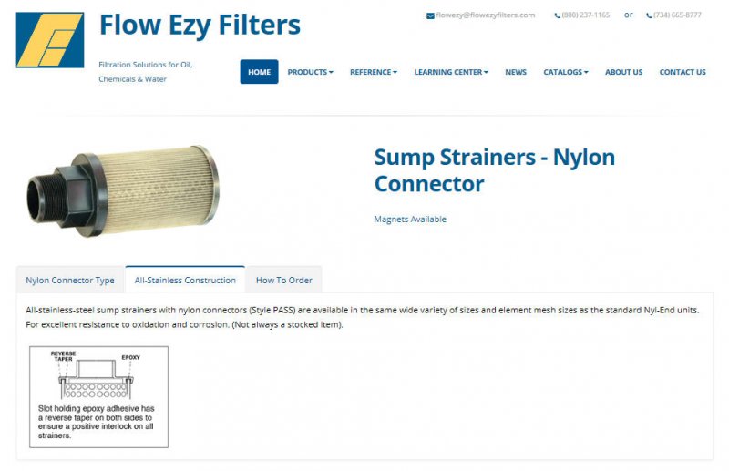

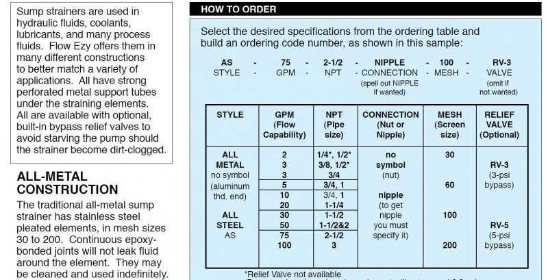

Flow Ezy's are originally designed for hydraulic fluid as well, I believe:
Note that all the Flow Ezy filters are rated in gpm, not cfm...

Nothing wrong with using something for a purpose different than it's original design if it works as intended - way, way more cost effective than designing and manufacturing a custom part.

Like I said, hydraulic filter.... Sorry 'sump strainer'..... Well, I guess the old machine I ran for 4 years is going to blow up.... I took the old filter in to hydraulics store, and he MATCHED the #'s.... I took it back to my shop, and ran it for 4 years.....
