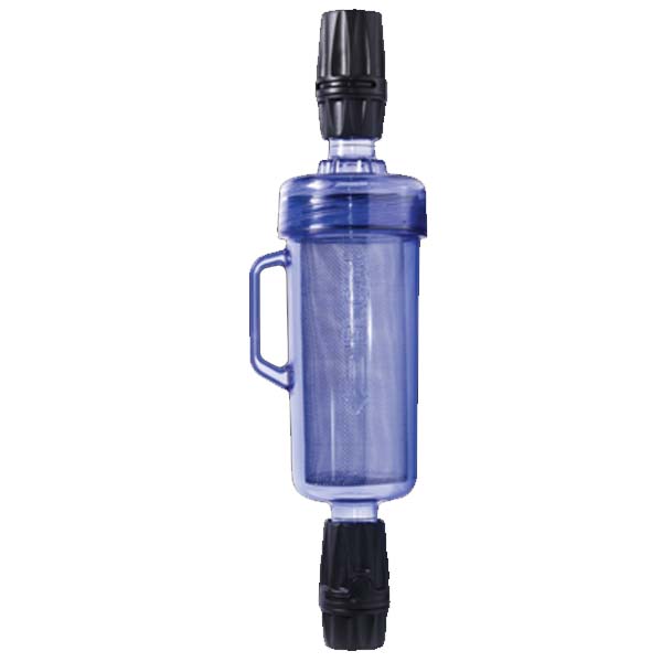

How many cfms are lost due to the restrictions of a blower filter? Seems like a lot. Looks very restrictive. Would it be better to have 2 pool filter types inline? This way seems to allow the blower to maximize air movement in the tank.
Am I over thinking this? Does it really matter where the filter is placed - before or after the tank.

I didnt mean pool filter literally .. sorry ..
This is what I use with the stainless screen .. I was asking if 2 before the tank would be better than using the one plus the use of a blower filter - to create more vac pressure in the tank.
One of those pool filters is way more restrictive then any blower filter (at least on Prochem tm's)should be.. I run filter less EXCEPT for the blower filter. My vac is always the best it can be..
