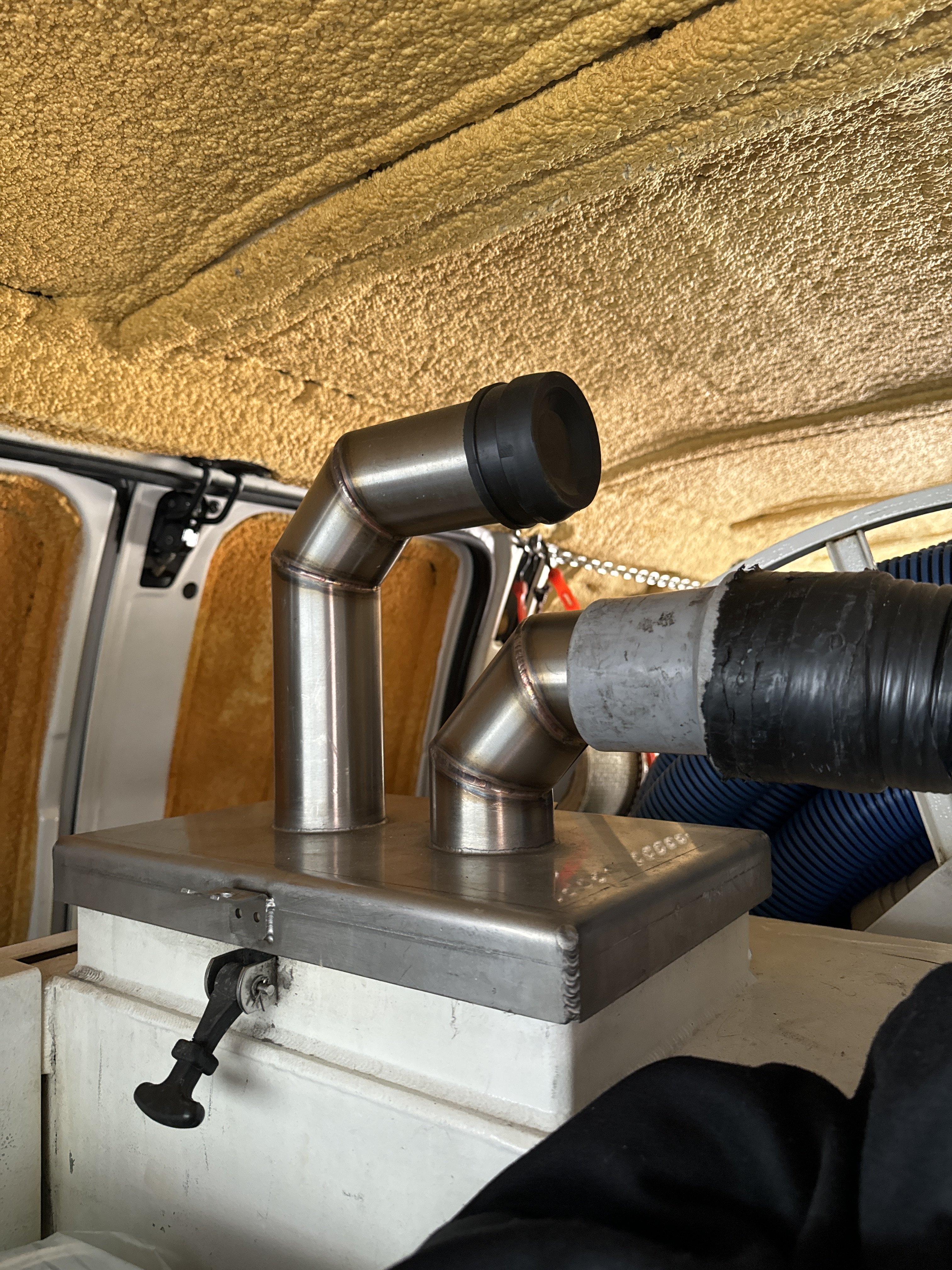

I did 3 jobs today, all in a higher end neighborhood.
2 jobs I ran 175’, and the third was 225’.
Now I run a supercharged mid level TM (47 blower, Cat 5CP pump).
By supercharged I mean I run the TM 600 RPM’s above recommended. (2850 recommends, I run @ 3450).
I also have a custom , stainless steel waste tank lid W/ 2.5” ports.
My first 50’ is 2.5, then I reduce to 2” for the remaining….
Everyone told me that running it like this would cook my blower, WELL….. that was 8 years, and 6200 hrs ago.
I do NOT regret running the system I have, and can EFFECTIVELY clean up to 450’….

That is sweet man. Looks like a powerhouse. How much gas does a setup like that use on an average work week for you? Is there much difference in consumption stepping up from something like a 370 to a 570?
Jun 20, 2016
6,527
Bc
Jeff T
What is unique about my situation, we own and operate 2 separate businesses, in separate cities.
I’d have to go through a few average weeks, total it up, and convert from metric to imperial… not a big deal, just need to some digging into it…
And no, the fuel consumption difference is relatively small.
It’s passing up on jobs that you couldn’t do because of limited equipment.
We do HWE, and low moisture cleaning.
They both have their pros and cons.
I’m not trying to discourage or sway you one way or another.
I’m not telling to go to something lile
A Vortex or Aerotech, or even the 870 for that matter…
The 570 gives you more room to grow your business from an ability standpoint.
The 370 is a great TM, it’s just a small TM…
