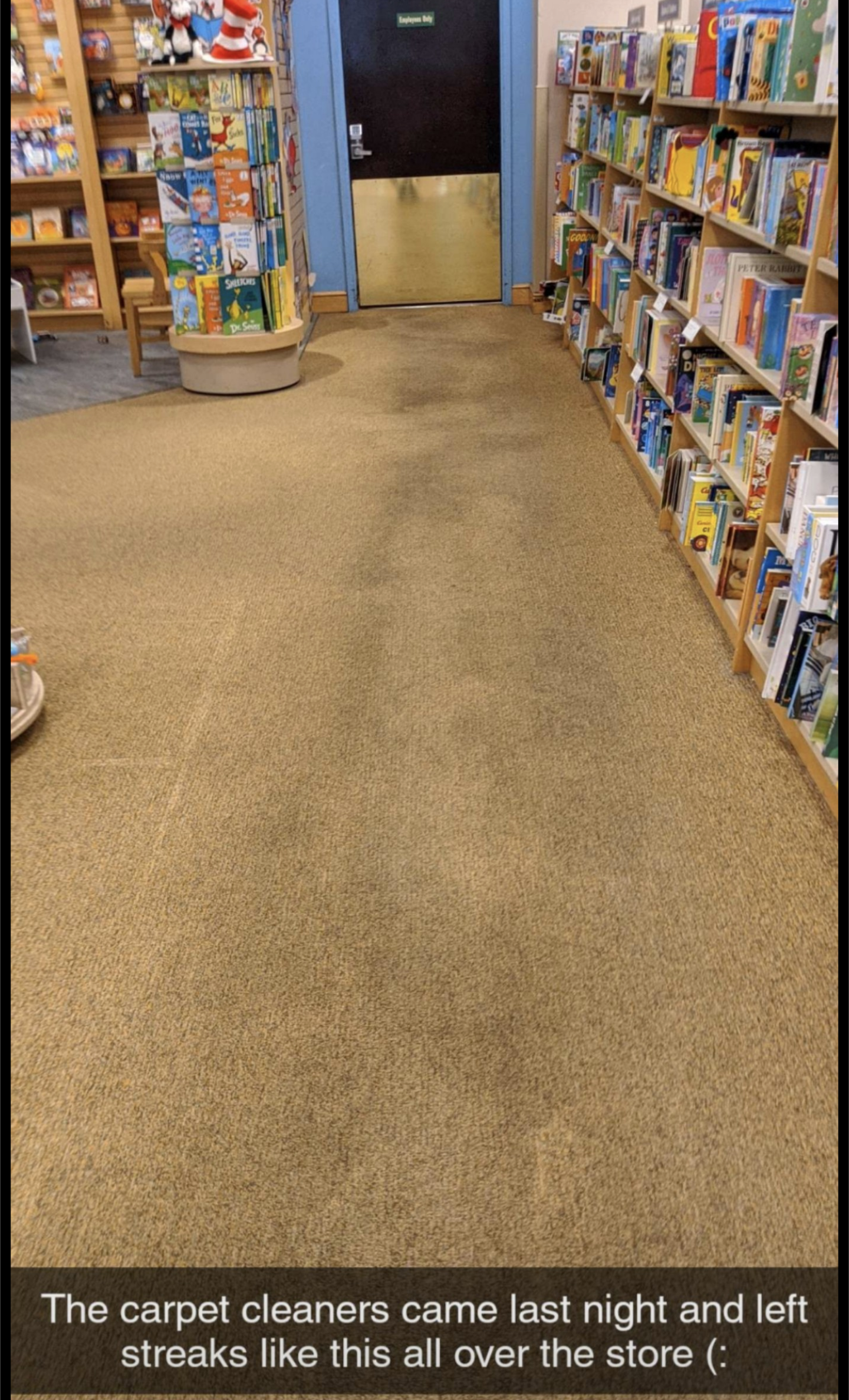

Last night somewhere in Louisiana.
......... don't know who cleaned it and how...
A random guy on Facebook said they only do VLM in
those stores because of all the books.
Not sure if that's true or not.
It's a friend of one of my kids so they asked me..
I said VLM it....
What say you pros....?

Looks like it was soaked during the cleaning, but to be fair, we have no idea what might have been drug across the floor coming out of the employee’s only area that could be wicking up.
A decent encap with some peroxide would probably handle it with ease.

Thats the day after and someone VLM'd it?
but no clue as to how?
Looks like RE wicking to me
Like said some one on Facebook assumed VLM I don't know how it was cleaned.
I would guess your probably right.
They said the whole store looked like that.
No kidding? Probably got soaked by some idiots on a crew either holding the Cimex trigger wide open as they walk, blasting a TM at 800psi, or using a porty with half dead vac motors.
I bet any of us on this site could have it looking pretty good, regardless of what went down.

the random guy only VLM's?
or they think the perpetrators of that mess were VLM?
looks like a blow 'n go porty hack job to me
No one knows how it was cleaned,
A guy commented on Facebook when I posted that those stores usually do vlm because of the books.
I don't know if he's right or wrong.
I think it was cleaned, and someone did a bad job.
Saying the got those money's worth because they paid .03 cents a foot, I don't know what they paid.
I just know it was a horrible job.
I told my daughter to tell them to vlm it.

Ok, fair enough…..
BUT, the job in the pic still looks like Shyte…
Whoever cleaned it, had NO IDEA what they were doing.
