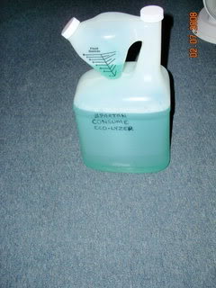

Be honest. Do you measure your prespray powders or liquids or do you use the glug method?
What do you use to measure with?
What do you use to stir with?
Do you follow the instructions? Even you Tide uses can use the measuring cup it comes with......

What do you use to measure with?A measuring cup we picked up at connections 4-5 years ago from the one time vender Sasco, best measurer we have found.
I put my 3-4 oz of O2 in cup, I use a Yellow anti freeze funnel to make sure it allgoes in my 2 gal Multi sprayer container. Then using my courtesy hose I rinse my measuring cup with hot water and pour that in the jug to.( No O2 residue in meas. cup when dried)
What do you use to stir with?A paint stir stick from Eagle hardware Have a stack of them in the shop(Wow, they went out of buisness in our town 8-10 yrs ago)
Do you follow the instructions?I mix powders in a 3 gallon bucket and stir till disolved. I do not stir my liquids, but shake. I add the powders to about a qt of hot water to disolve and stir before adding the remainder hot water needed.

Greenie offered this tip for me today.... If you have a favorite pre-spray with known dilutions measure it once and pour it into your hydraforce. Then take a sharpie and make a line on the hydraforce. There you go - from now on no measuring cup needed. Too friggen simple.

i have a hydroforce revolution, and i have chemical feed on the machine. when i do have to measure i have a glass measuring cup.
putting the line on the hydroforce works but it quickly comes off if you get even a little prespray on it.
