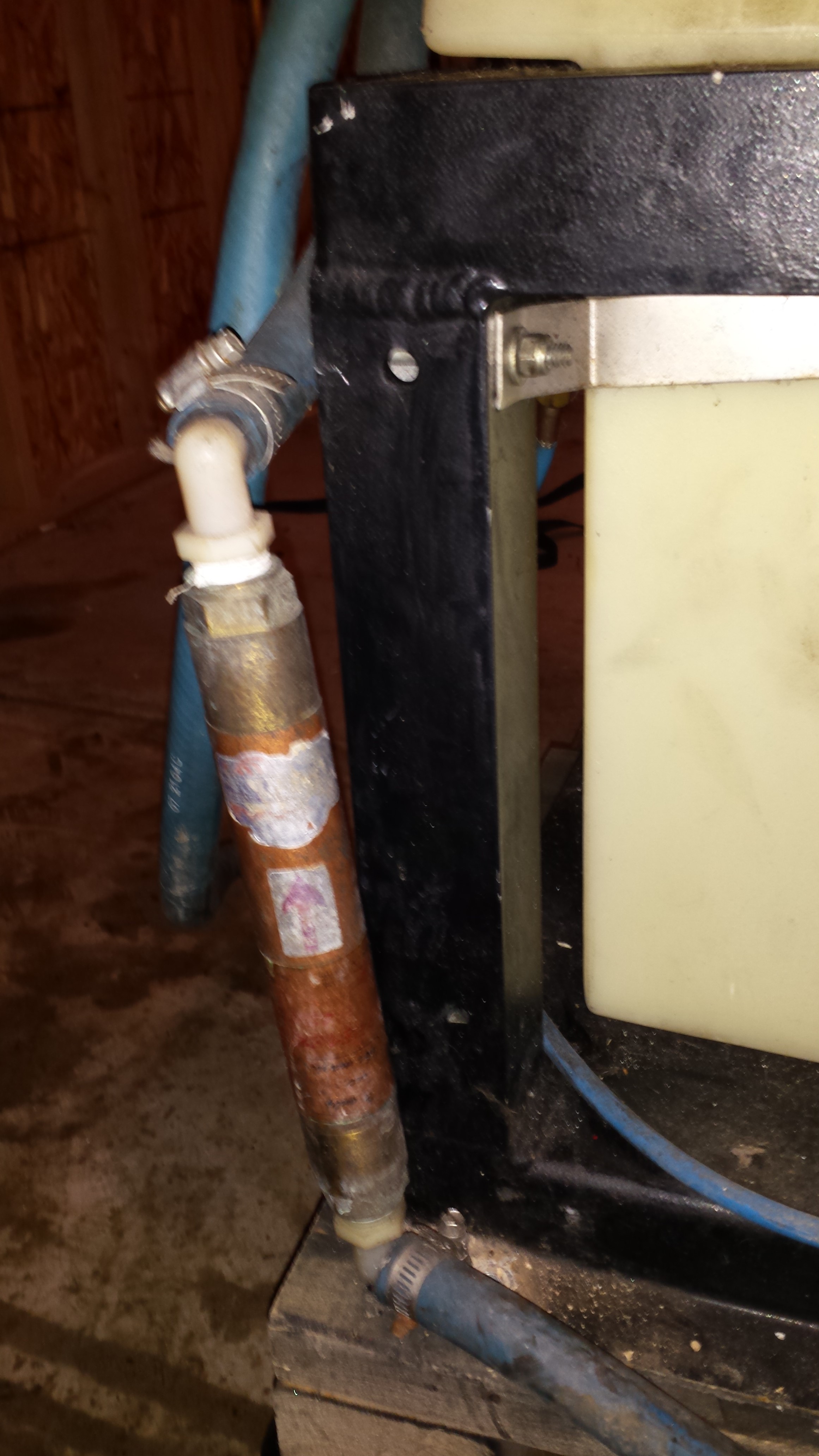

Keith I broke a copper pre-heat exchanger once too. At least you didn't break the stainless one. Just curious how difficult it was for you to reassemble the machine?
I took the heat exchanger into a radiator shop for them to take a look at..
If you just take one thing at a time both taking it apart and putting it back together it's not so hard. Just take your time and remember how everything is set up..

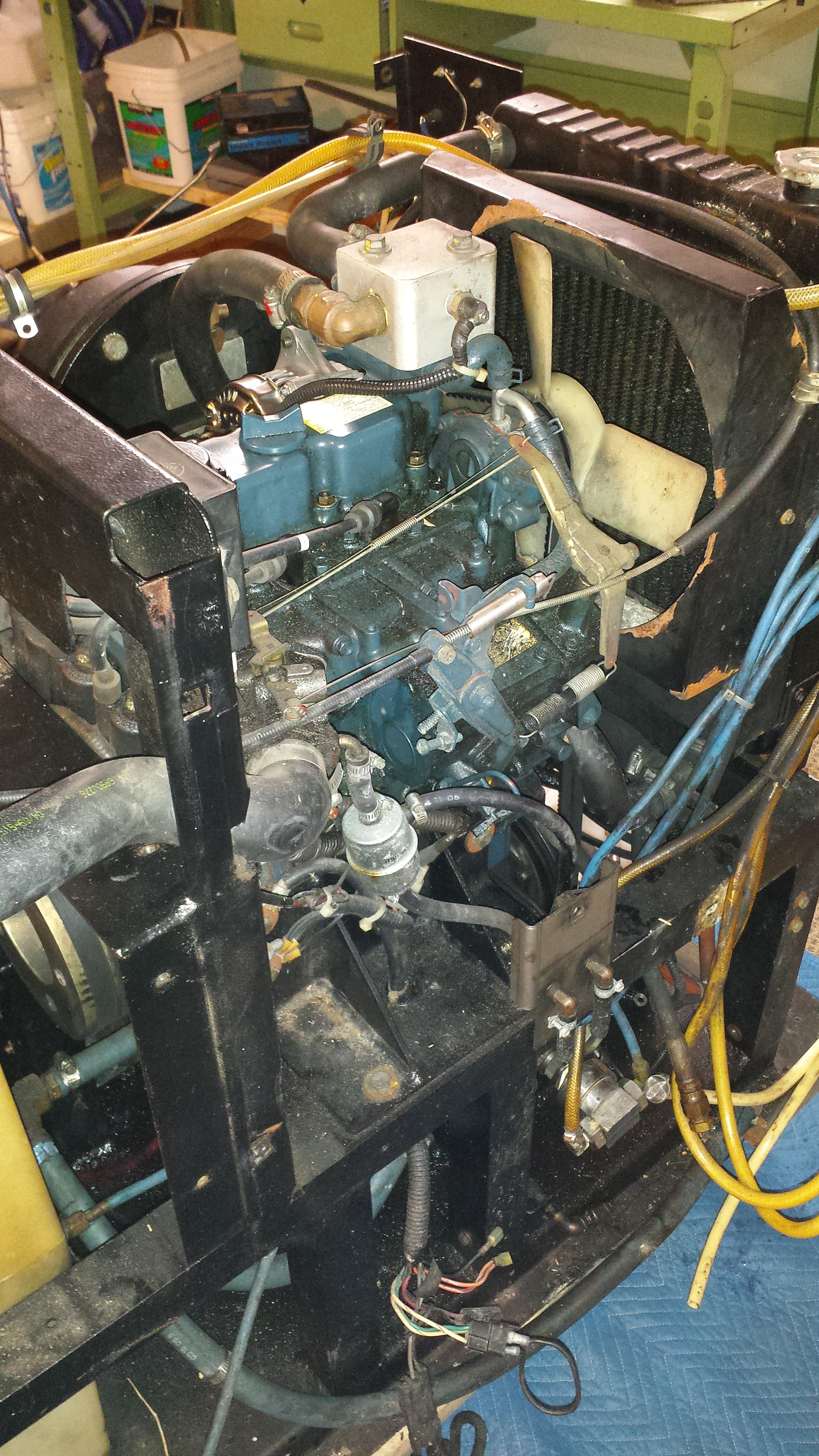

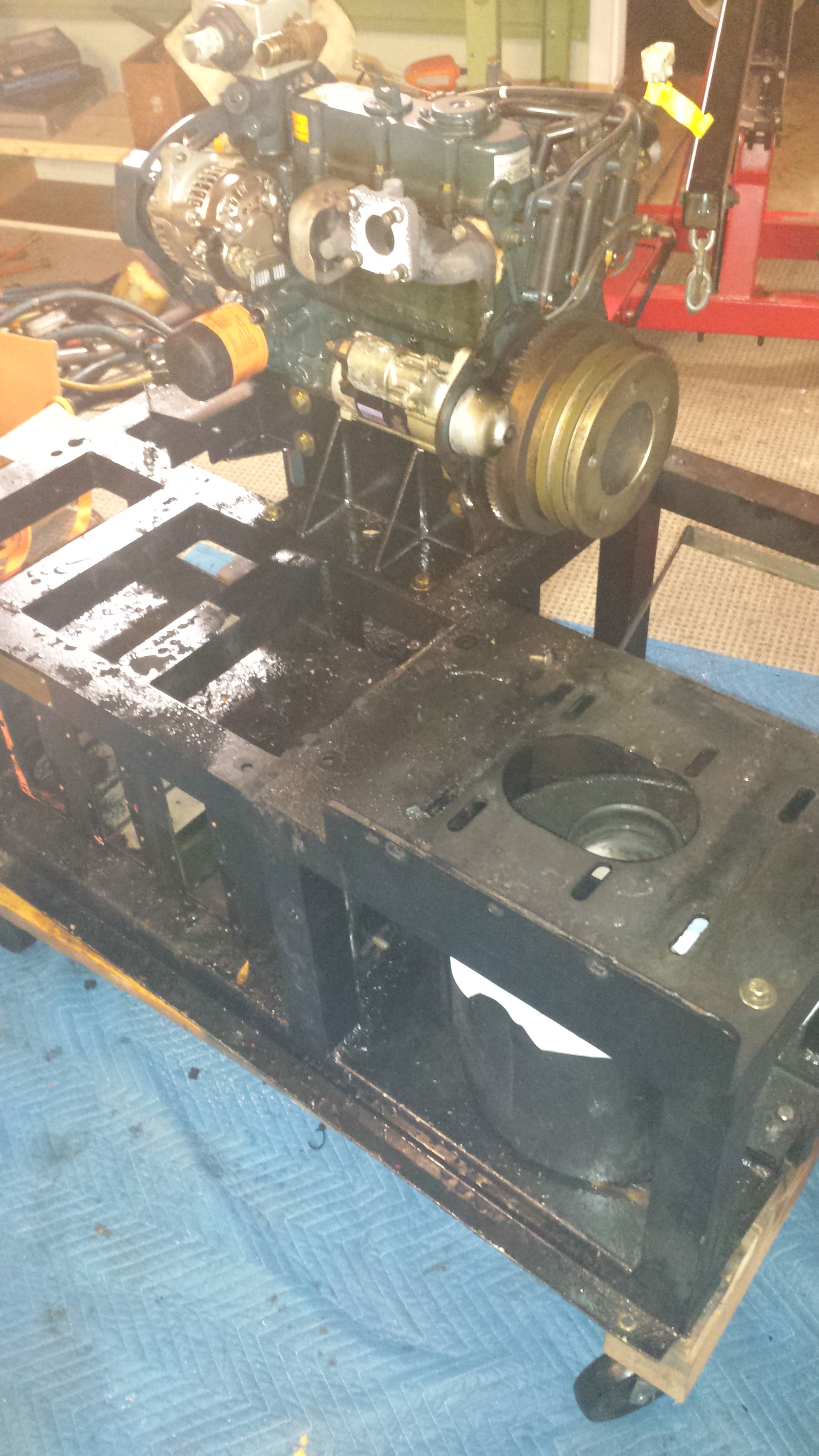

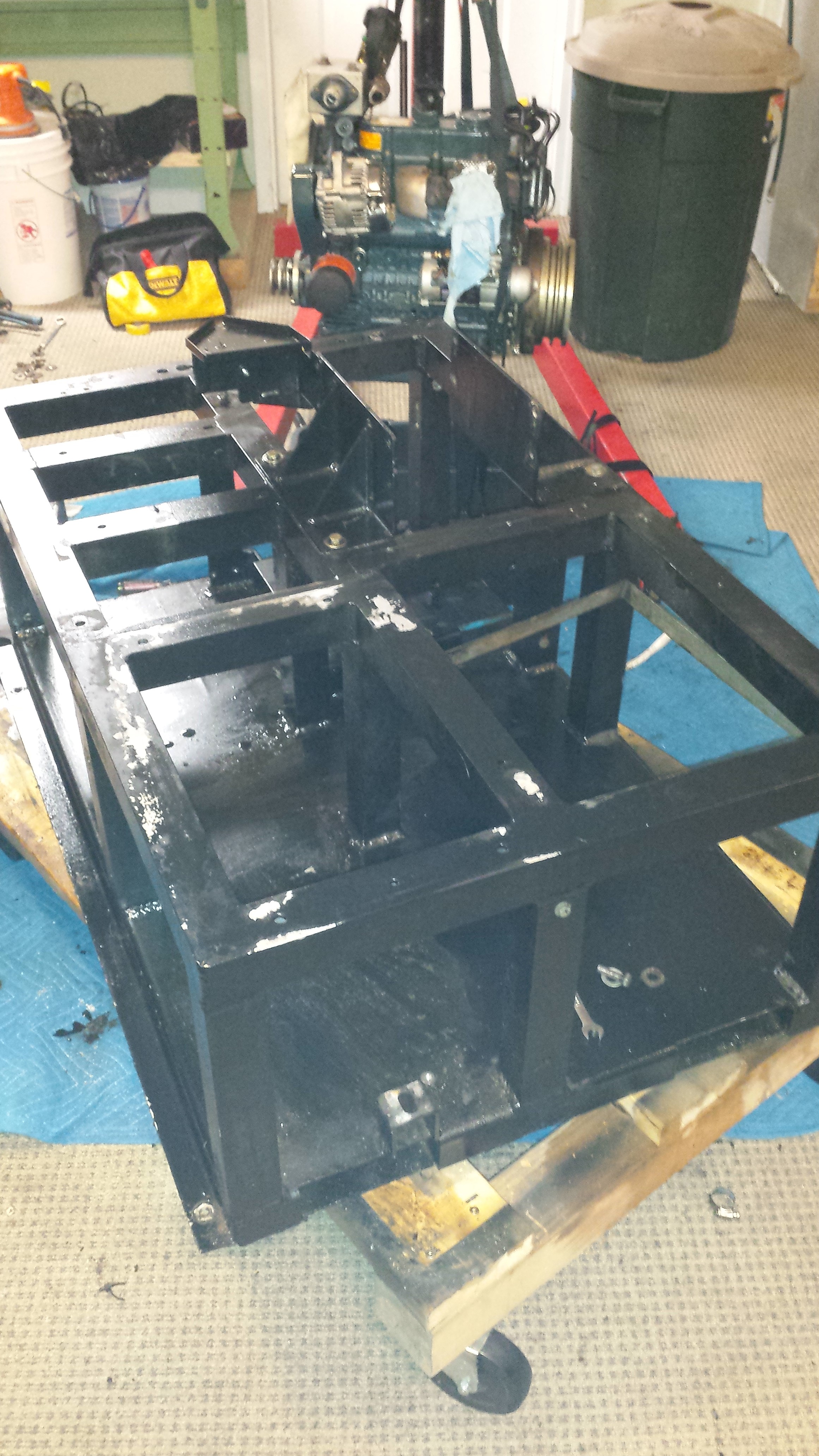

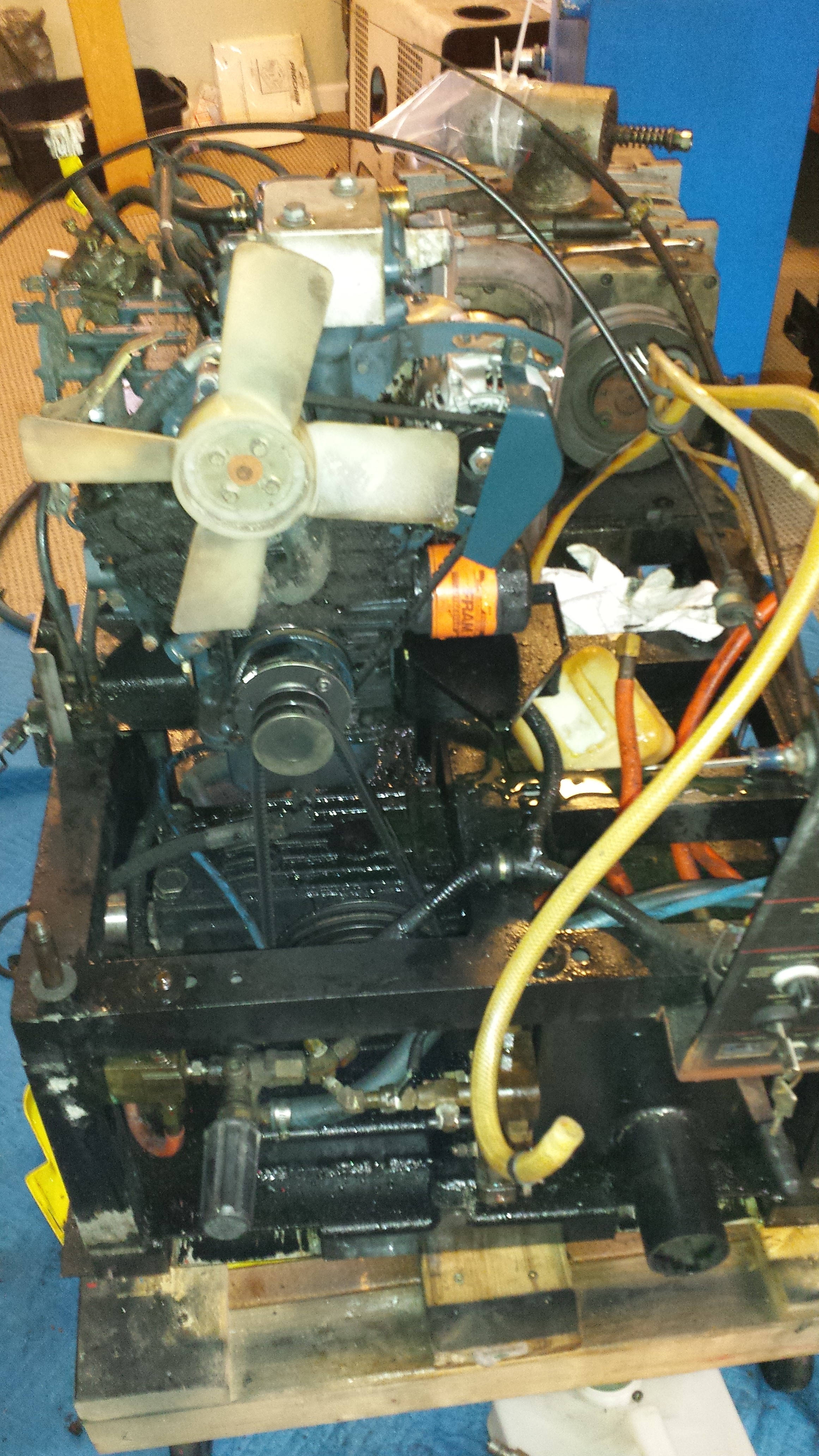

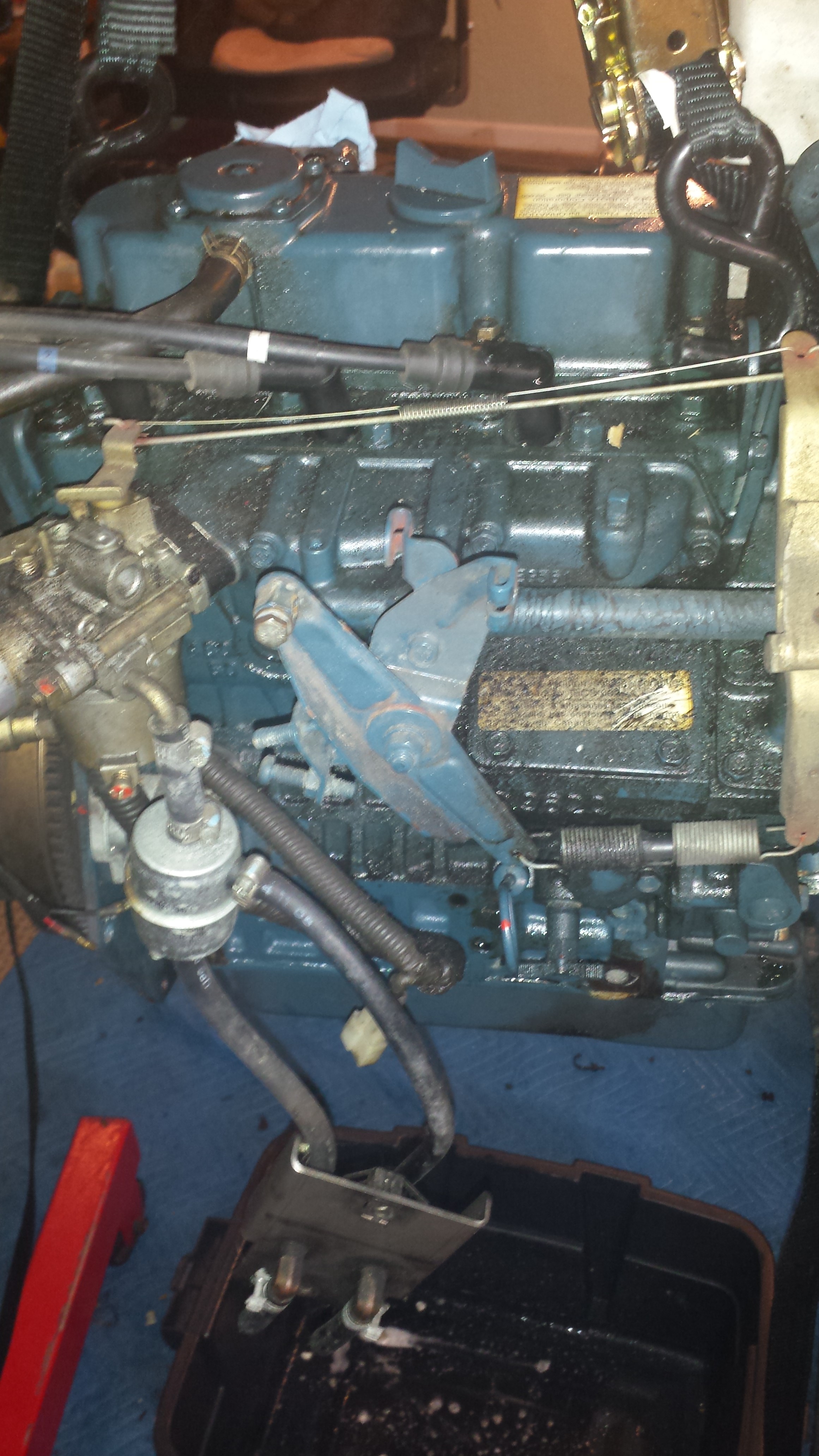

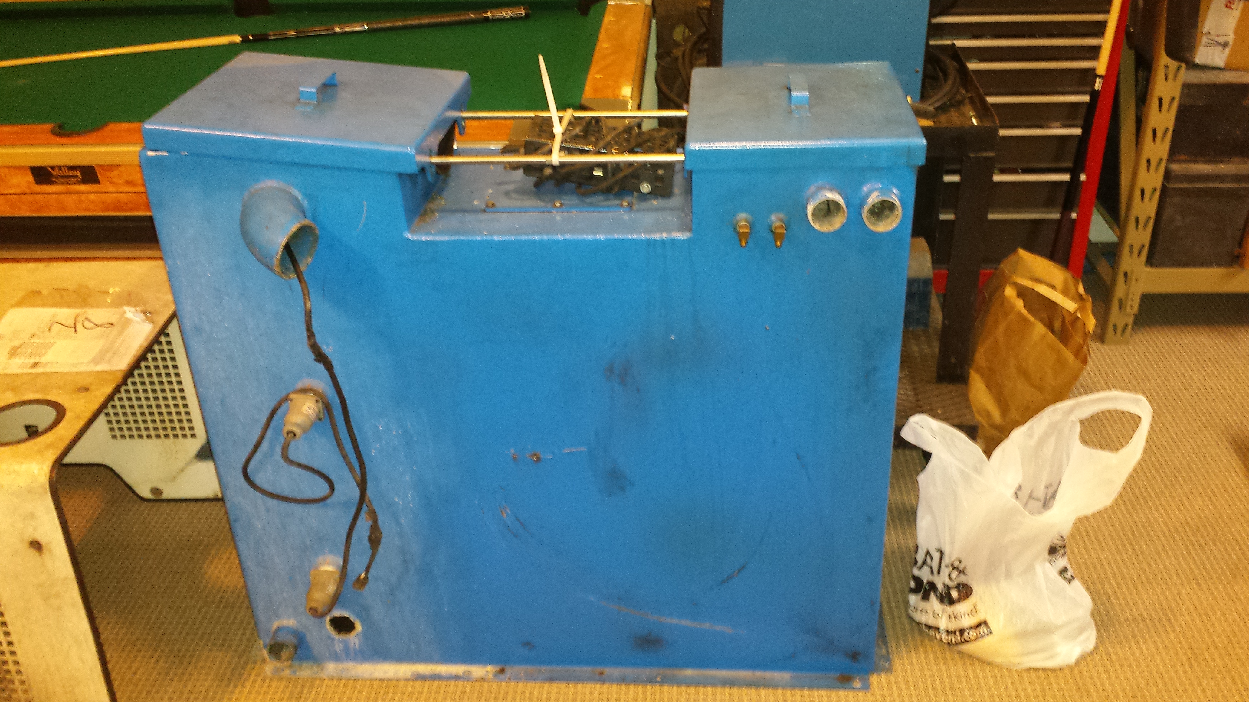

This one was a LOT of work, nothing went easy for example::madder:

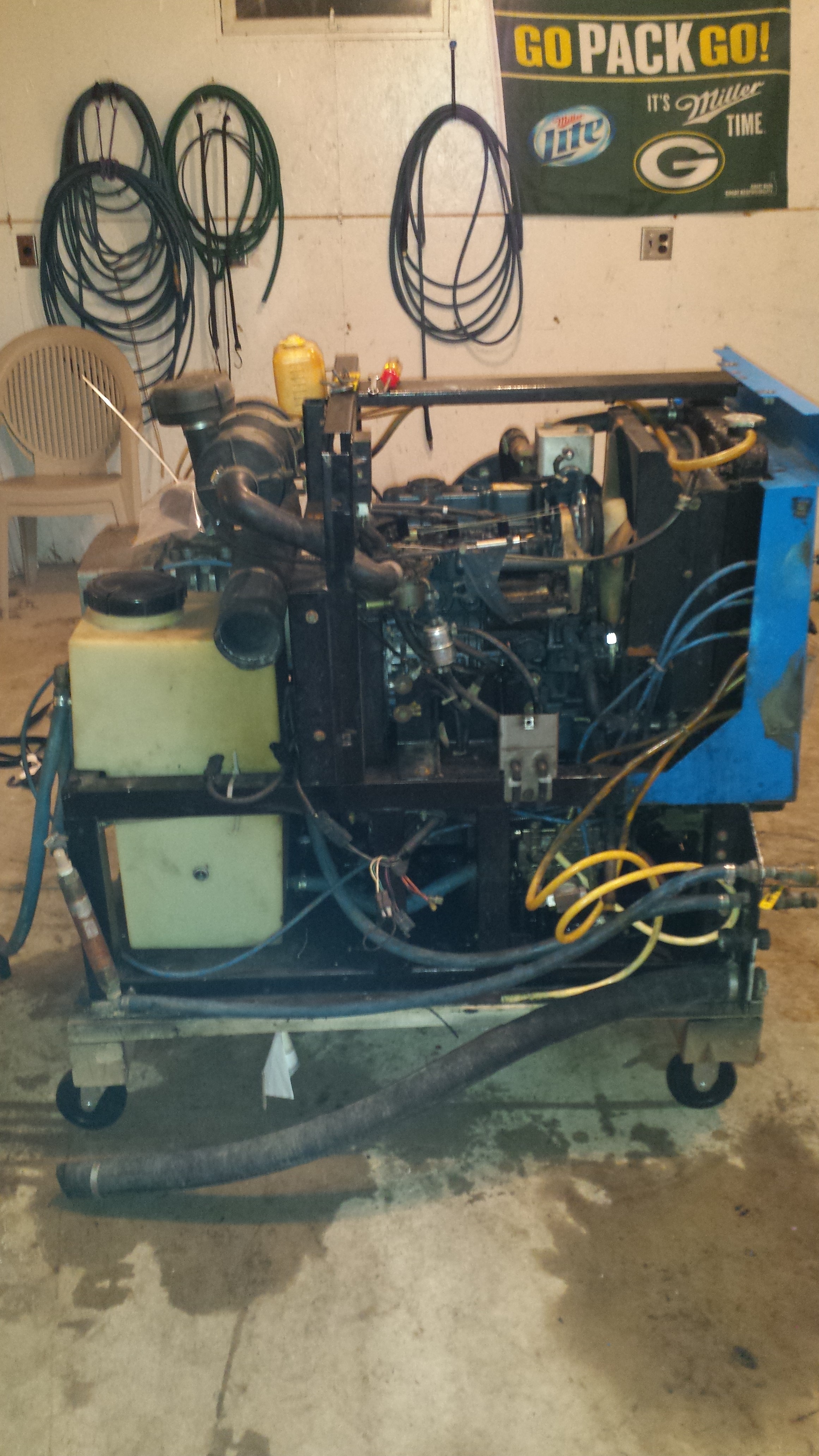

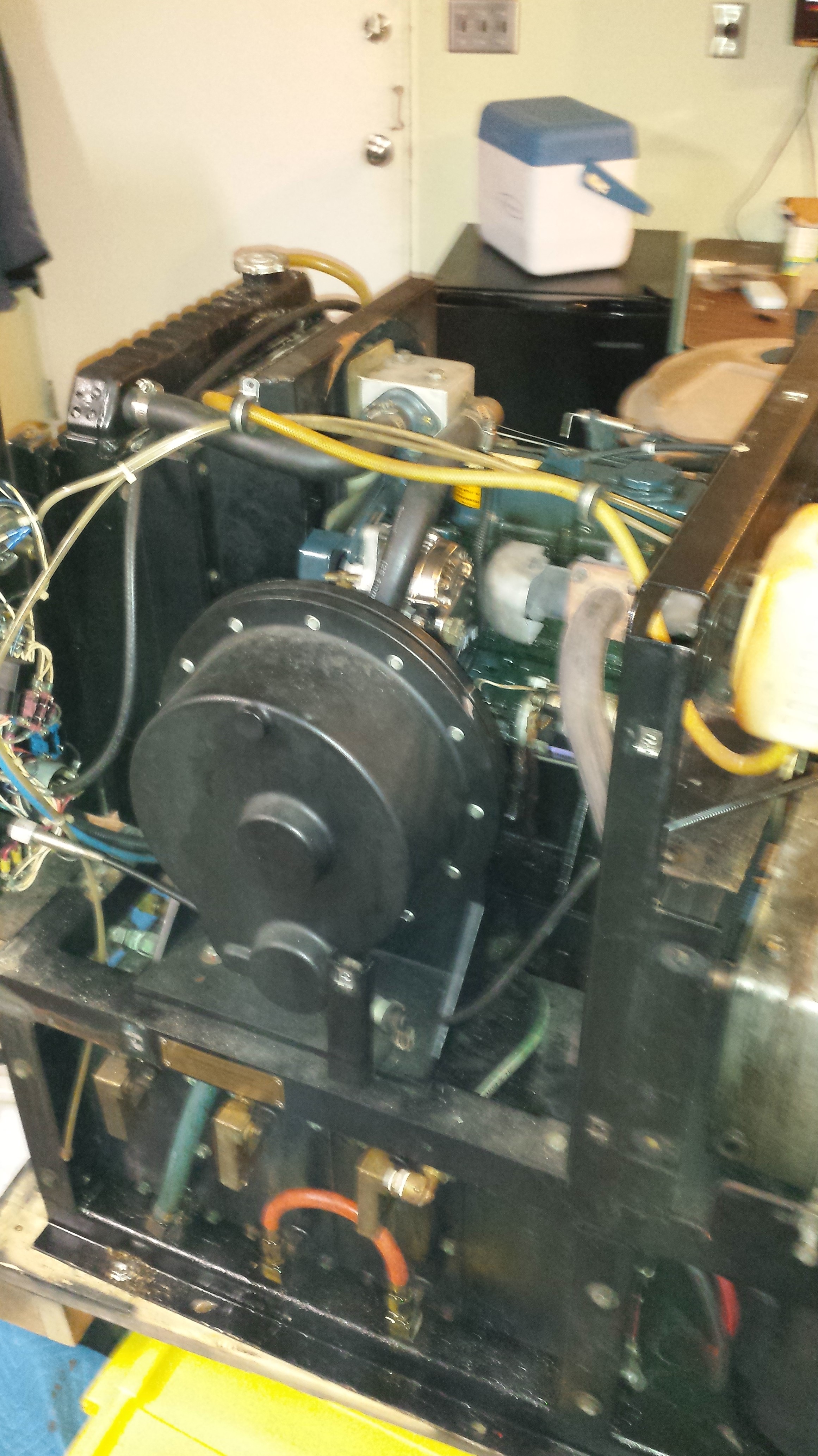

Plumbed and wired..

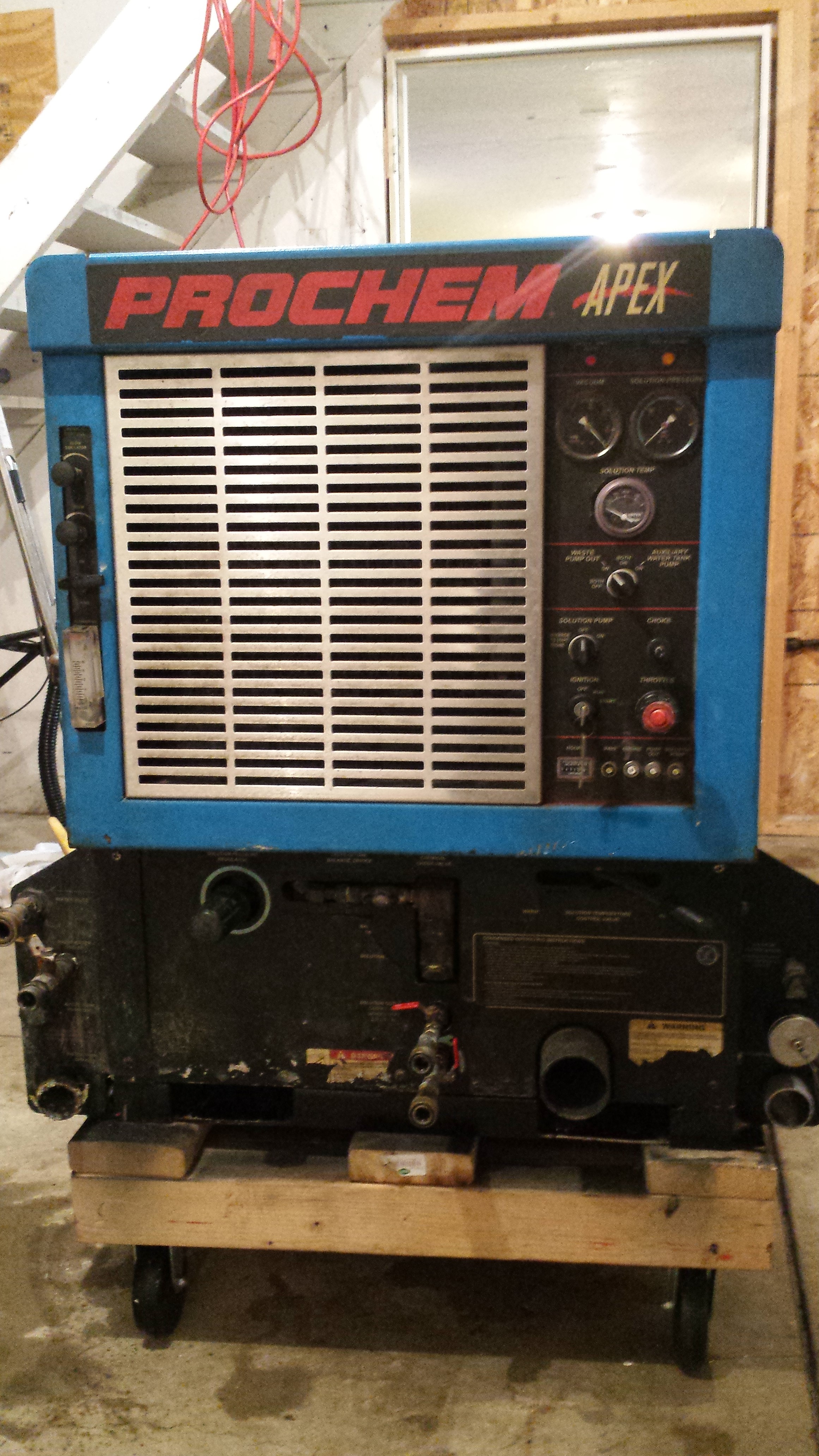

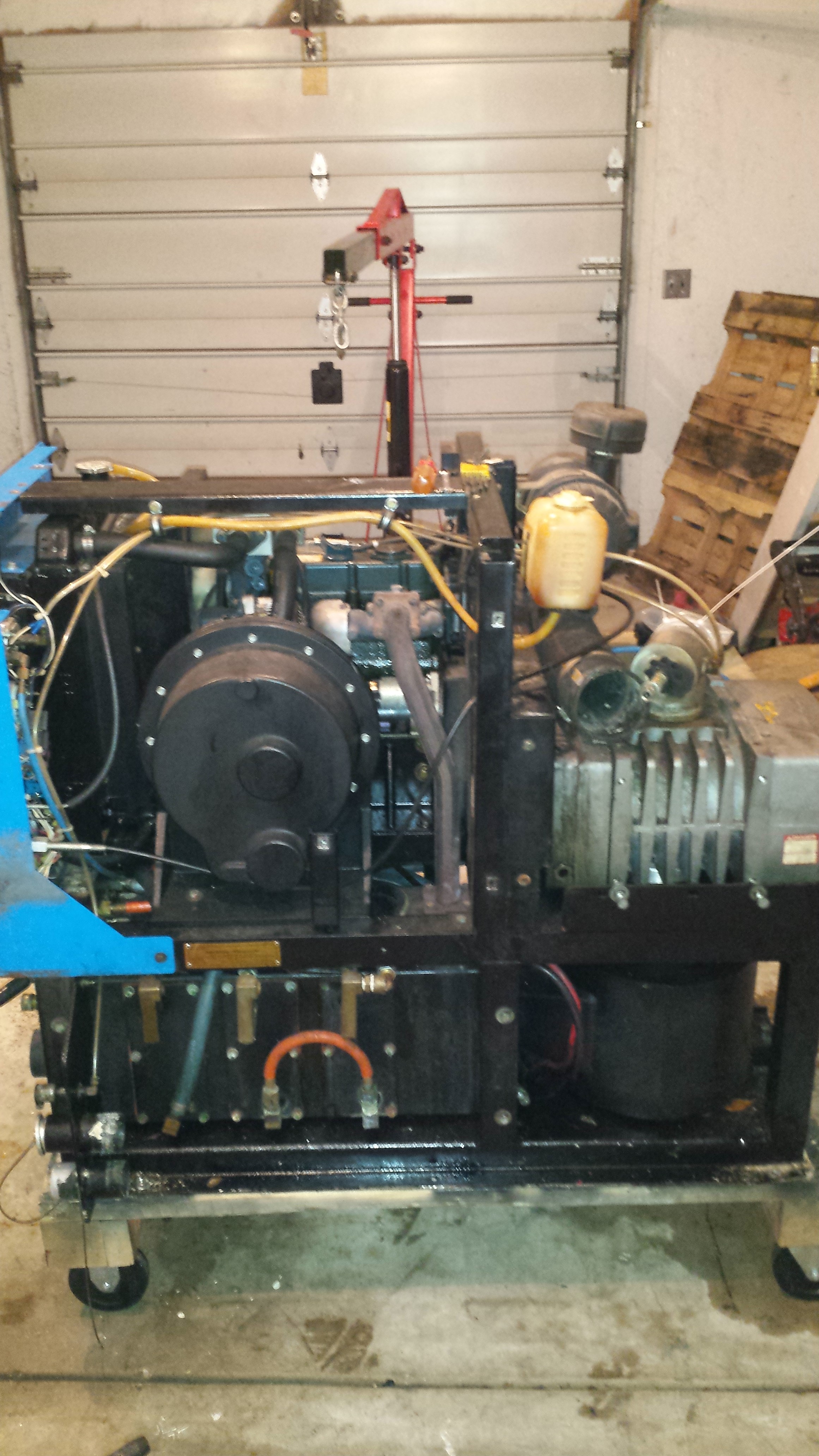

Planing to run it tonight..
I decided to go with these hood latches instead of putting the rattle clips back on..
