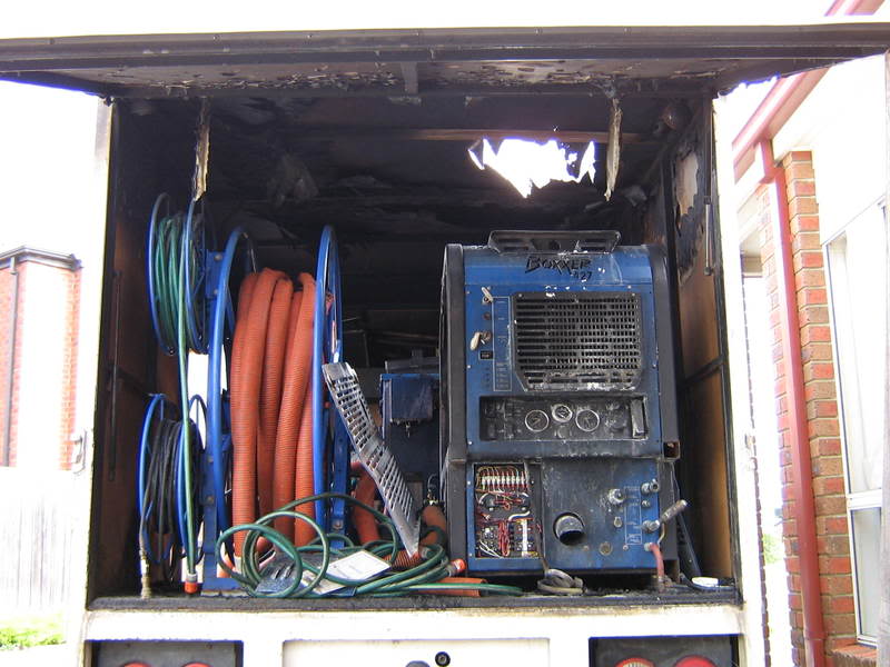

Here ya go :)

:p I only said it was my favorite Hydrmaster Picture. It only had 500 hours on it and was 11 months old. The fire didn't start until they where wrapped up and driving home. Could have been really really ugly.
Interlink had to yank it and send it back to hydramaster to completly re-wire and re-plump it. Personally I wouldn't have taken nothing less then a new machine. I am still waiting for them to call me and tell me it burned to the ground.
Chris i'll go take pics of the 427 we have here that is in peices and get the ones of the one that was sent back to Interlink in peices if that would make you feel better :lol:
On a serious note I love the CDS units. I have nothing bad to say about them at all. Matter of fact I recommend them over Butlers all the time. If I am going to lose a sale the least I can do is help them make the right choice.

Geezus, I own a 427 900hrs nothing major. What's the story with that pic?
