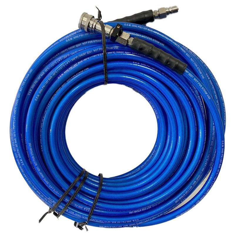

Seen this hose from Steambrite and wondering if anyone has used it and how well it holds up.
Turbo Heat Thermo Retention Hose

I had one of those. What i really liked about the hose was the very thing i thought id hate about it. I bought mine at the trade show in Las Vegas in 2016 from dultmeier supply. What i thought id hate is how stiff it was but it easier to maneuver with it it was harder to carry from the van its smaller in diameter and cooler to the touch when using because it uses rayon braid instead of steel the ends are (at least the one i had) stainless. The outer casing is plastic and will cut easily on door seals and is easier to puncture to rayon versus steel braid all and all i want to buy them again but i can only find 25',50' and 100' and i want 75' another plus is they are quite a bit cheaper than neptune 3000 buy it try it you may quite possibly like it too. Im going to try Steambrite monday and see if they have 75 footers!

Exactly the same thing Cobbs supply sells.
I’ve got a 150’, and a 250’ section.
I’ve had mine for about 4-5 years, and have babied it the entire time.
I NEVER hook it up to the TM directly.
We always run 100-250’ of Goodyear Neptune before using it.
We only use it on long hose runs, and high end jobs when I’m concerned about ‘tattooing’ on high end carpet in million/mutiple dollar homes. It stays cooler on the exterior jacket….
It does retain heat over long distances, however, it a PITA to work with.
It doesn’t like to go around corners very well.
It’s fragile.
It’s very light weight.
Good back up solution hose, but I would never use it as a main line.

I ran mine for about 3 years as my main hose before i snaged it and ripped .
I don't use standard wands i clean with rx20 then rinse and dry with a drag wand this hose really really shined with the drag wand because it was so light and stiff enough to stay outa the way

As Dwaino mentioned, you might find it difficult to adjust to the stiffness of the hose, as it’s not as flexible as traditional pressure lines. I'm not sure if there is a measurable amount of heat retention, but I can tolerate the hose. There's no risk of the "black death," since there is no wire inside. The 150-foot roll weighs the same as the 50-foot Neptune hose of a similar type. Some cleaners have reported issues with seepage after 2-3 years, but I haven't experienced any significant problems aside from slight cuts, bruises, and some fading of color. I've donated two hoses—a 150-foot and a 100-foot—to an aspiring carpet cleaner. I bought my first set at Dultmeier and my second set at Magic Wand, which sells both 150-foot and 100-foot lengths.
Do what's best for you!

I bought it for one job 3 years ago because I need something quick to get to the end of an apt. hallway. Still using it daily. Bought another 300 ft.

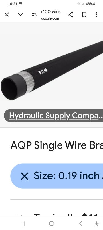

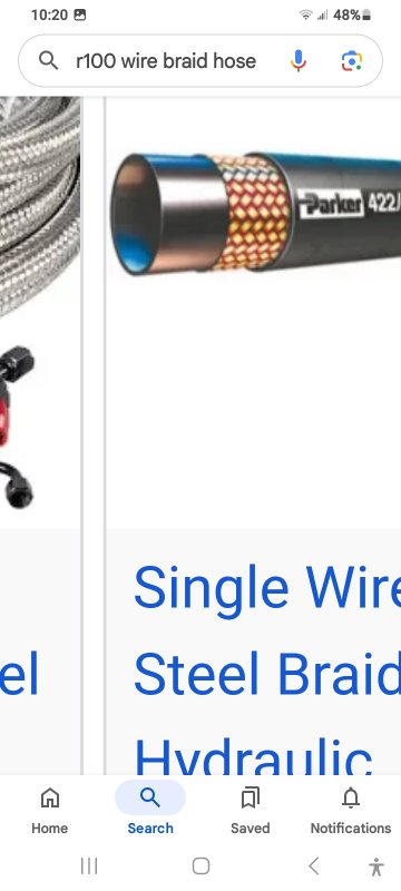

Black death is not attributed to the wire braid. Its the black inner hose breakimg down that causes black death the steel braid doesn't come into contact with the solution rather it surrounds and reinforces the inner hose outer blue casing/intermediate wire braid-support/ inner black rubber-something solution hose
14,079
And speeding up that breaking down of the black rubber is caused by using alkaline rinse mixed with high heat. I went through so many different brands of hoses in a short period of time before I realized that my rinse agent was causing it

Sure, it makes sense, coil inside the hose rubs against the black rubber, and term " black deeath" is born. There is nothing inside of thermoplastic hose, but plastic.

NO NO NO!!! You clearly do not know how these hoses are built . Black death is the rubber inner hose degrading generally from chemicals the wire braid has nothing to do with it . Here is a picture on how a 100r (single steel braid hose) is built

The thermal plastic hose is constructed the same but with differant materials for instance regular hose outside blue cover rubber other hose plastic. Regular hose inner refocusing braid steel, other hose fiber. Regular inner hose(soulition carring) black rubber other hose possibly teflon (i really don't know) but both hoses are constructed the same they just use differant materials in the construction.

Think of these hoses like an inner tube. If the tube is outside the tire you'll never be able to put much air pressure in it. Itll just swell bigger and bigger till it pops. But put it in a tire and you can greatly increase the psi while matianing the tubs diameter Solution hoses are the same without the steel braid i wouldn't take much pressure to expand the hoses diameter till it pops n but incase it in a steel braided jacket and you can greatly increase the pressure in the hose . The outer (blue)jacket is there to protect the steel braid. Many industrial steel braided hoses dont have an outer cover because abrasive resistance is unnecessary

" Clearly " I don't, but when I cut the hoses to make whips for my five Hydro-Force sprayer blocks, I see what you see, just don't describe it in a great details 😉.
