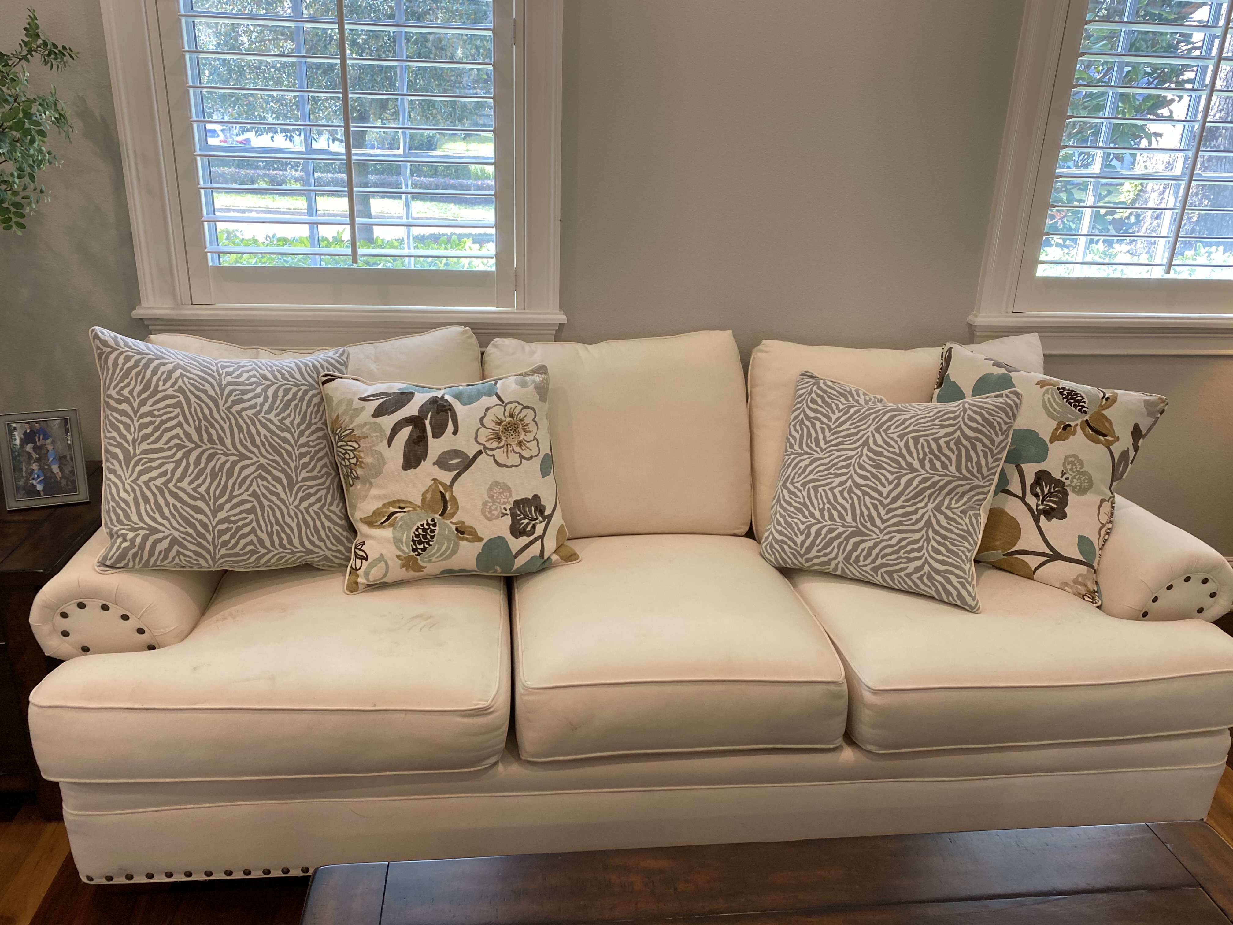

I have cleaned these before. The upholstery browns so quickly.
I have used a Dry foam method with a sponge. I've also HWE with an upholstery tool using a low pH product. The products claim to be anti-wicking/browning. Both ways do not get the results I am seeking.
Other than dying from the fumes. What can I do to clean this couch with soil removal and wicking? Even if I sneeze on this, it will brown quickly.
Burn test shows polyester/cotton blend. Inside has feather stuffing inside a white covering (IDK what fabric is covering the feathers. It may be cotton also).
I just zoomed in on that pic. Is that an after shot of the job or before?

Are you working with an existing browning claim? If so, I'm happy to help you to resolve it, if possible.
That's good. But no, I am not. I just shared this photo because I have been coming across this type of upholstery far too often.
I always test the fibers (burn test only) and see what I am working with. The last few I have done were already stained heavily (browning) and I did not want to proceed with this particular couch since it had minimal damage. Light staining from dog trafficking soil from outside.
