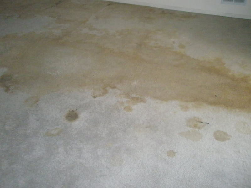

Wow, when are you holding your next training class?
I don't think I would have even attempted that one. Skeered, maybe. Nice work.
We got to find you some clean carpet to clean. Some people do that you know.
Ron Lippold said:
6 gallons of quat alot and no smell
yea right.
"no smell" when you left.
That sumbeech will smell like a toilet after it's been closed up for a few days
and some hot humid days while closed up, and it will REEK
the backing and pad are severely contaminated with urine too
If you advised the owner of the severity and what "really" should of been done ...and "he" chose the aqua-velva spritz instead,
that's one thing.
But if "you" SOLD him on the idea you could "fix" that pi$$ pot (and charged him an arm and a leg) you're a HACK that doesn't know any better.
or WORSE..., you're a "say anything for a buck" schmuck
no offense guys, but most urine stains aren't terribly difficult to remove with oxys
(which there is plenty of in Judson's juice)
We also use and love Quat-a-lot
BUT...the backing and pad is still a CESSPOOL of nazzzzdeeeness!!
side note, I didn't dog Ron (pun intended) on his other doggie pee thread.
It appears someone lives in that home.
Ron most assuredly "improved" their environment.
However, this thread looks like an empty for rental or possible sale.
Someone is going to be moving in on that toilet paper unaware.
might be kids and babies crawling around on that thing

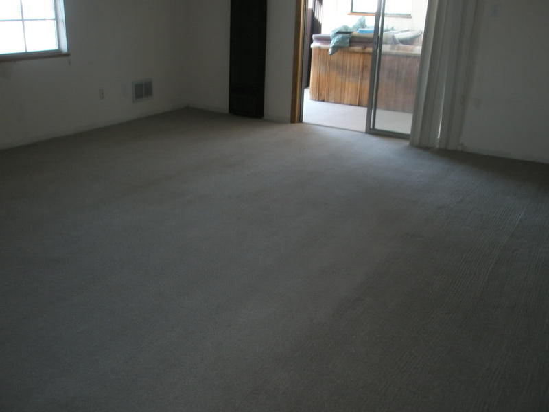

Are you sure that's all dog spots?
Sure there's some there, but check whats in the room on the outside in the second picture... Spa pool.
Did you check backing? Jute backing and cellulosic browning?
Again, a good oxidiser like what was used would clean that up real nice and may not have an offensive dog urine odour at all.
Then again, maybe Ron set you guys up too... :lol:

the first one had a family living there and a new baby crawling on the floor, they were not getting rid of the dogs I no it was better I begged her not to wait so long. The vacant is a rental that I have been back into and no smell.
15,250
Ne
As much as we educate the customer there is a point where you have to give them what they want.
G
honestly, I have to go with Larry on this.I would do the job if I had to but I would have pulled the pad,urine pretreat (acid)let it dry, bin the whole backside,reinstall pad,enzyme,let dwell,final rinse and spritz with some hydrocide and hope that I got it good enough.
Kevin
PS-and seal the floor with the bin
G
Nice job Ron; Glad you guys weren't in N.O. after katrina man; that dog stain was nothing. He did a good job; got paid; and made the best judgement call of all; Please custy. I am sure he put down enough chem to make it clean.
you can't put down enough chem to reach the pad unless he used a FIRE HOSE to FLOOD it
we've done toilet rags like that.
I'm sure we'll do them in the future too.
However, the custy will be advised as to what it will take to attempt to fix it "right".
if "they" choose otherwise, fine and dandy.
I'll let it go and leave it with this;
I've seen the same from OPee padders when they oooh and ahhh over a pi$$ infested berber that "looks" great after deo spray 'n wiped
I know and you know, the pad and bottom of backing is FULL of contamination.
ya'll can brag about how it "looks" all you want
