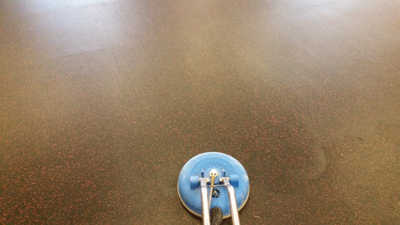

I will look for my pics, but we ended up using a small CRB we have with the standard white brushes (on a 10 inch), and then ended up doing a turbo spinner on them (these were 10 years old and pretty good shape)
Think the psi was at around 800 psi....we set the psi to lowest setting to make the spinner spin.
We had done some testing with just a prespray and hard surface wand clean....then a crb scrubbing and alkaline cleaner and clean with a hard surface wand....
Then just Turbo....then CRB scrub and turbo....
The CRB scrub and Turbo gave us the best results....

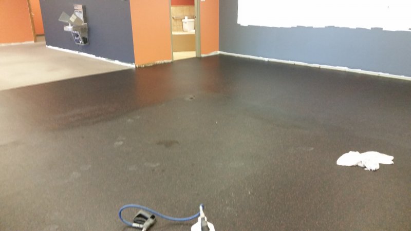

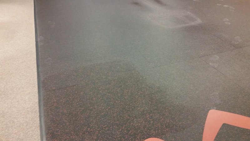

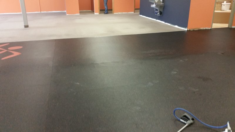

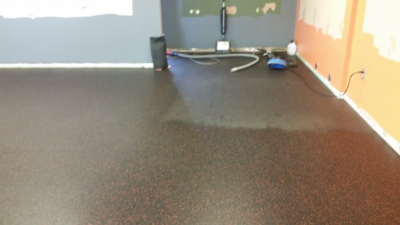

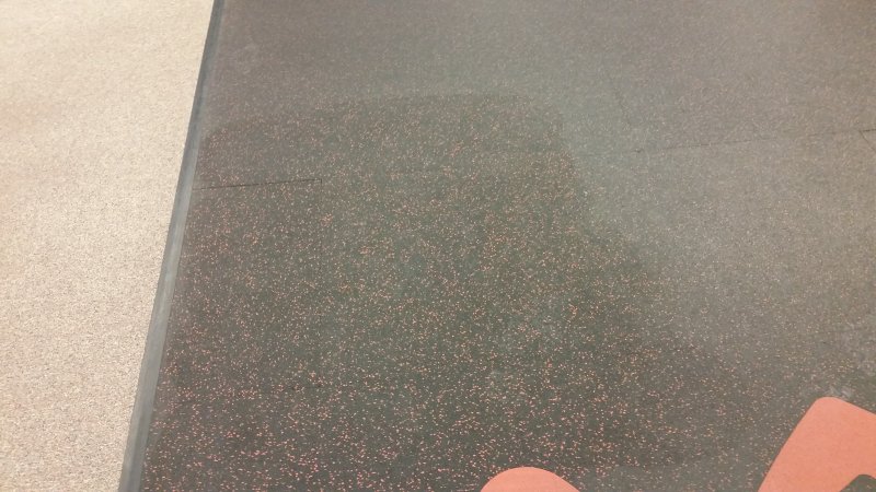

Here are some of the pics from the job. The first pic is our cleaning test area we had done previous about a month earlier, but then another company ended up being awarded the job....and the new building renter called because the other company could not match our test cleaning spot...Now the kicker....the surrounding area around our clean spot was just cleaned by the other company awarded the job....They ended up having to pay us to clean the place....at our price....
These are tough to clean just so you know....and some are harder than others...
I really was thinking that a Zipper would be my next choice to try, but honestly thought this could be a job the new CX-15 would shine...

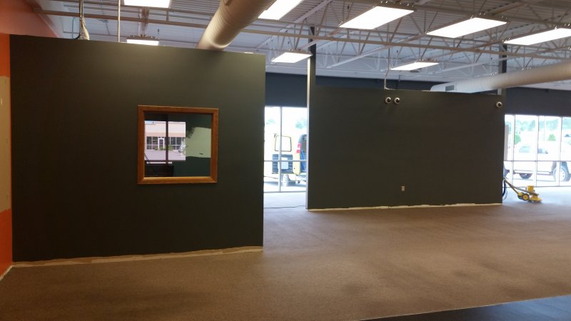

We ended up going back and cleaning the carpets too....they couldn't quite match our clean spot of that...even had another local company try too....Love that :)

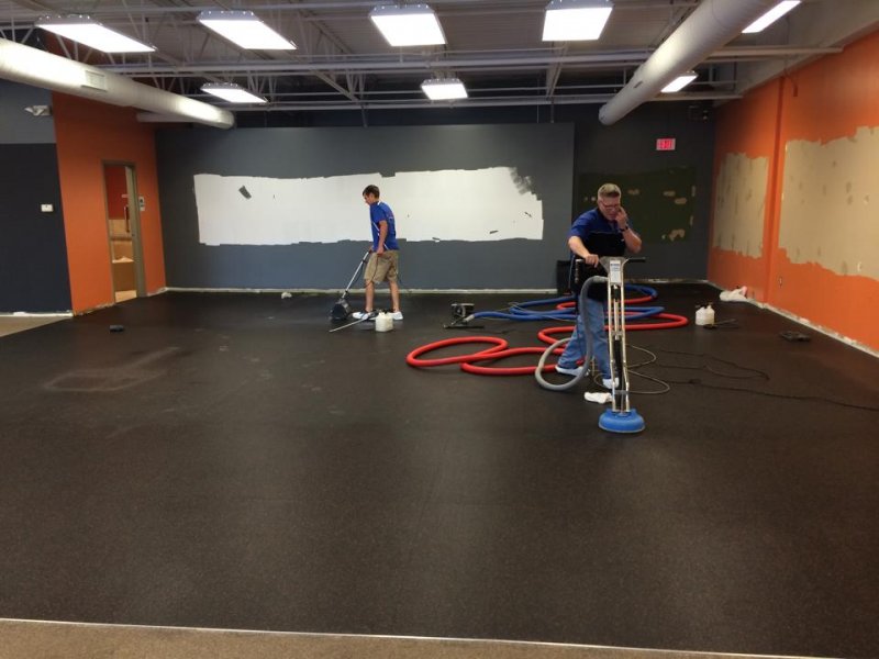

Other company in background trying to clean the carpets....

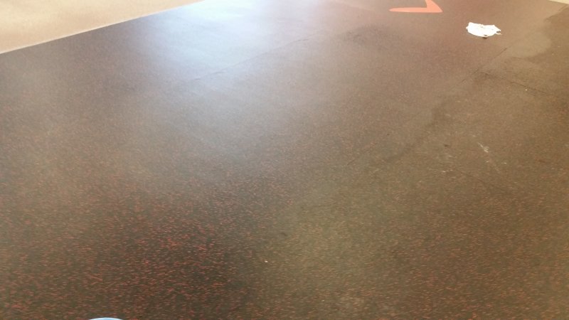

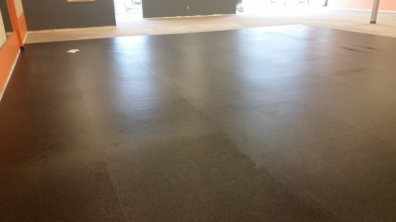

Almost done with the Flooring

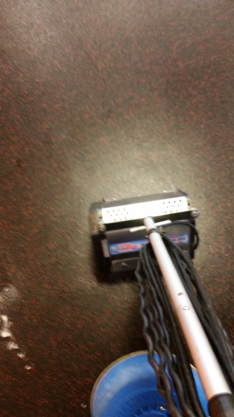

Agitation with standard white brushes that come on this 10 inch CRB

So what did you use as a prespray?
A special Harvard blend that is alkaline based.....
This was a special situation, so we were trying to manipulate the colors back to a new condition to match new additional mat install that was joining the old matting.
I think the G Force Booster (Soy Based) in the formula helped to get back some of the shine and remove some of the deeper soils easier with suspension.

I have tried a few of these floors. The best result I had was similar to what Mark did. Presprayed with midl alkaline, pH about 8. CRB machine (20" Brush Pro that is rated for use with standing water) to scrub. Rinsed with an SX-12 spinner tool (800 PSI) on part of the floor and a 14" Gekko wand in another area. I think the CRB did the cleaning. The other tools were for rinsing.
