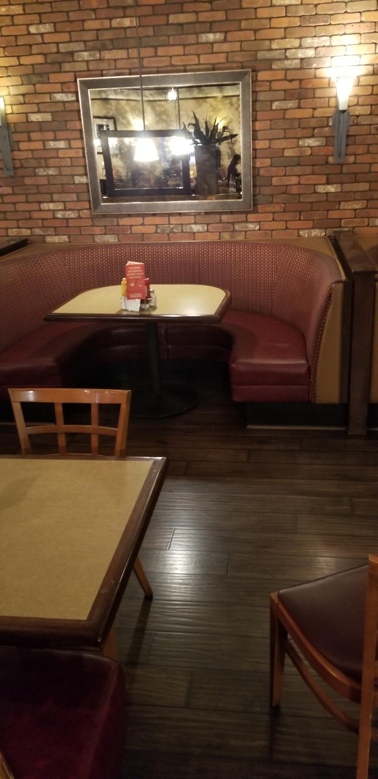

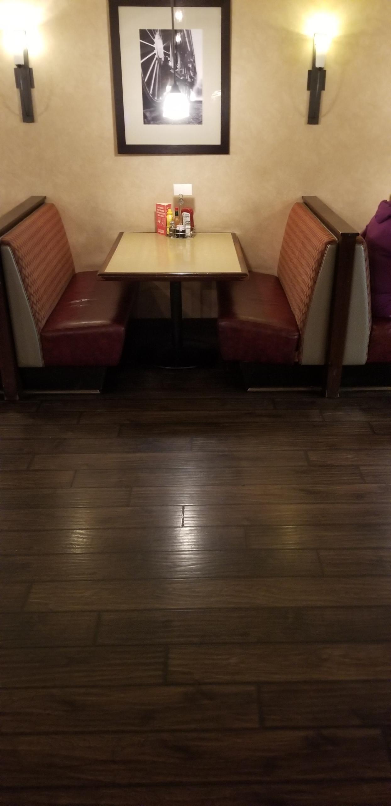

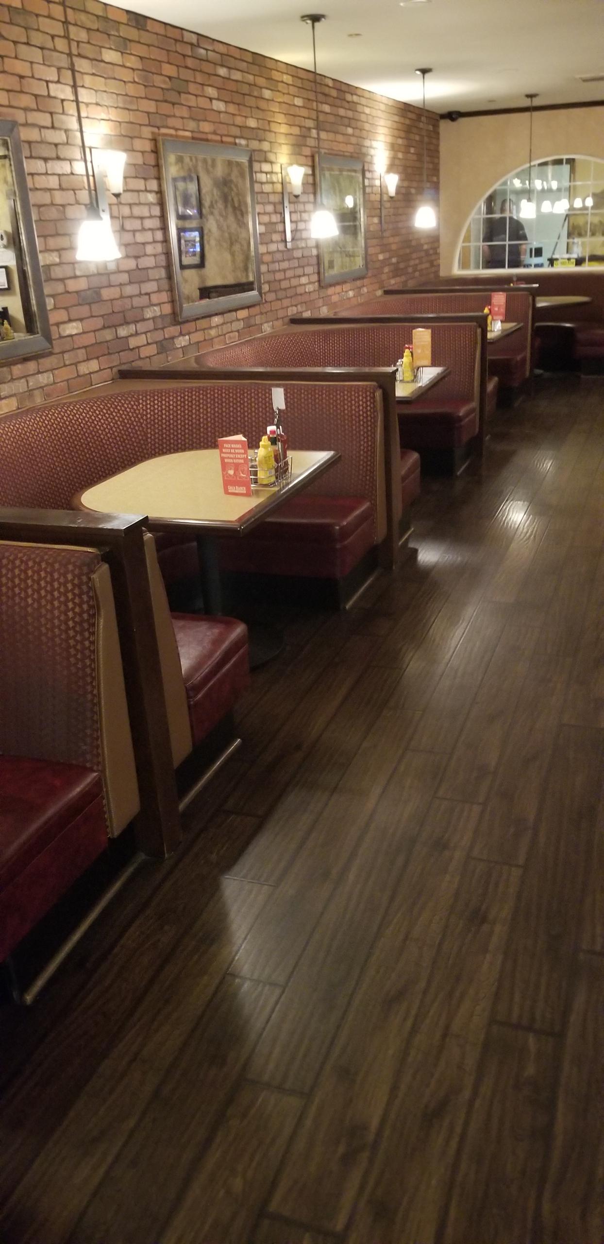

On the 2nd floor of a casino..
Hose run may be tough to impossible.
Pixie and a shit ton of towels it is..

That kinda job is where a micro auto scrubber shines!! It’ll get under those tables slick as a whistle.

Doesn’t look dirty. Swiffer and invoice.
We did a ‘few’ bank staff rooms over the last few months. All had vinyl plank in them.
Let me just say this.
There’s WAY more dirt hiding in those fake looking wood print &cracks than you think…
As in, neutral prespray, aggressive agitation, dwell, and wand rinse @ 600 psi,. Then a final mop.
Don’t believe me?
It was a system developed, trial and error, 19 times over 3 months…
AND, all but 2 ‘looked’ clean…
