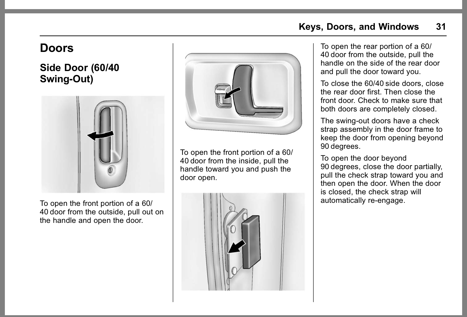

The cargo doors do not open all the way back like they used to.

I know how to hold the piece back as you open it, they changed the hinge so it doesn’t go all the way back.
https://my.chevrolet.com/content/da...als/2017/Chevrolet/Express/Owner's Manual.pdf
