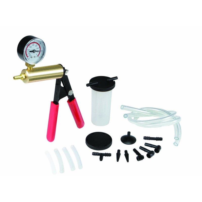

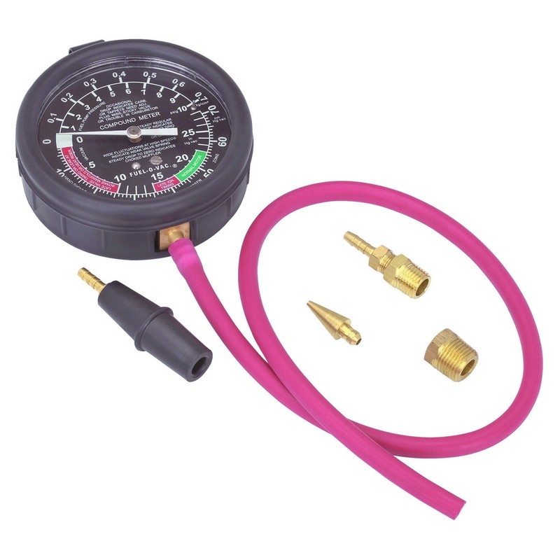

Invest in a cheap vacuum gauge to make sure the vacuum level is where it needs to be.
http://www.harborfreight.com/fuel-pump-and-vacuum-tester-93547.html
That way you'll know whether to look at the actuator or back at the lines etc. for pinholes, kinks, and such...
dgardner
Apr 7, 2008
5,109
Phoenix, AZ
Dan Gardner
A common issue (on vehicles anyway) is the actuator diaphragm will develop a small leak. It will move some but the vacuum leaks off fast enough that it never achieves full travel. If you hook the hand pump up to a leaky actuator it will move as long as you keep pumping but will leak out and return to normal position as soon as you stop.
