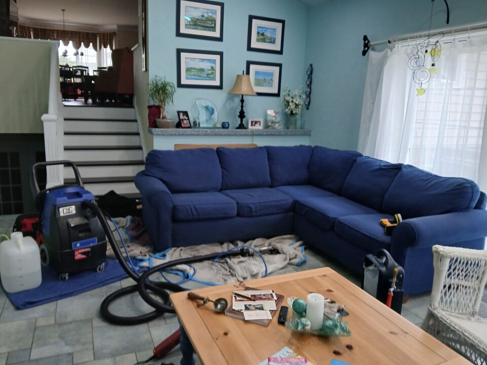

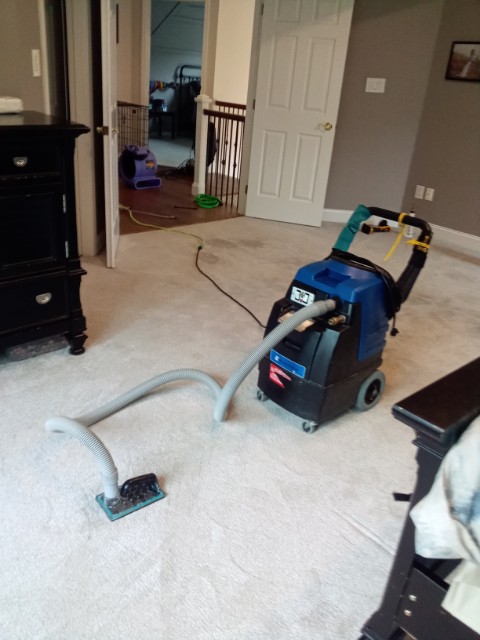

I did this job today. One chair, 2 Bedrooms, Hall, Living Room. I used 3 gallons for all of that. I rinsed the chair with water and that is not included. I haven't been HWE for 6 years now so I don't really remember how many gallons it would take to do that using the HWE Method but I do know it would take many more gallons than 3
How many more gallons 10 ??? 15 ??? I don't know but compared to VLM, HWE uses and WASTES many many more gallons of water
That carpet is a cheap Polyester. I used 2 oz VacAway Double Trouble and 4 oz Detonator (Peroxide) per gallon on chair and carpet
I'm starting to like that Sapphire Portable Upholstery tool. It uses too much water but adding a shut off solves that problem
LESS water MORE agitation !!!

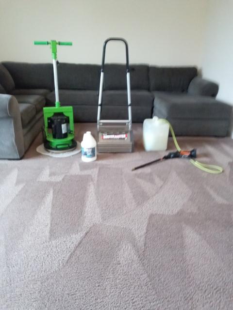

Yes I leave the MESSY Look and I like it
If I thought there was something wrong with the MESSY Look I wouldn't post pictures
I don't worry about perfect groom lines. When the customer starts walking on the carpet those lines will disappear fast. They're not deep lines
I use a 10'' CRB with soft brushes. That carpet is thick nylon and the lines are mostly just on the surface because the CRB is light and has soft brushes. A carpet brush/rake leaves deeper lines than a 10'' CRB with soft brushes. A 10'' CRB grooms the carpet better than a Brush or Rake. My opinion
I never get any negative comments from customers but do get criticism from other cleaners. If I start getting negative comments from customers that's when I will change my opinion on the MESSY Look
I'm more concerned with getting the carpet clean and dry than groom lines
I like the MESSY Look !!!

View attachment 133018View attachment 133016
What’s that tube on the back of that portable? Some exhaust muffler thingy to help catch all the crap air exhaust that comes out of that machine into the customer’s air???
SteamwayPro
Apr 8, 2012
354
George
It's a muffler that catches noise
Without the muffler it's loud and very annoying
With the muffler it's probably 50% quieter
When I'm prespraying and scrubbing furniture I have machine off
I only have the machine running when I'm extracting
I like that Sapphire Portable Upholstery Tool
