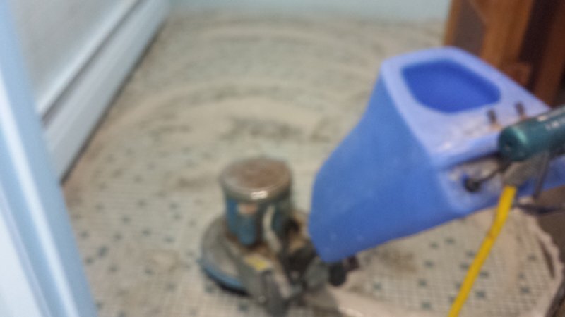

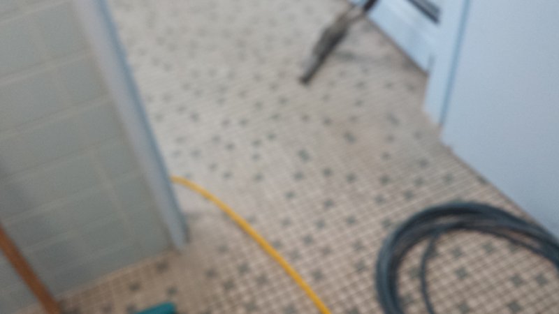

Sorry about the above. Wrong pic. 30 year old mosaic in a swimming pool situation. Blackened grout,mopped daily. I hit it with this and the customer was ecstatic. More pics to follow I have 3 newer scrubbers but you can't beat my 20 year old faithful, Ol' Rusty Mastercraft. He's made me a lot of money, never broke down- hell I haven't even replaced the plug. They just don't make em like that any more.
http://greencleaningproducts.ca/products/tile-grout-cleaner/
