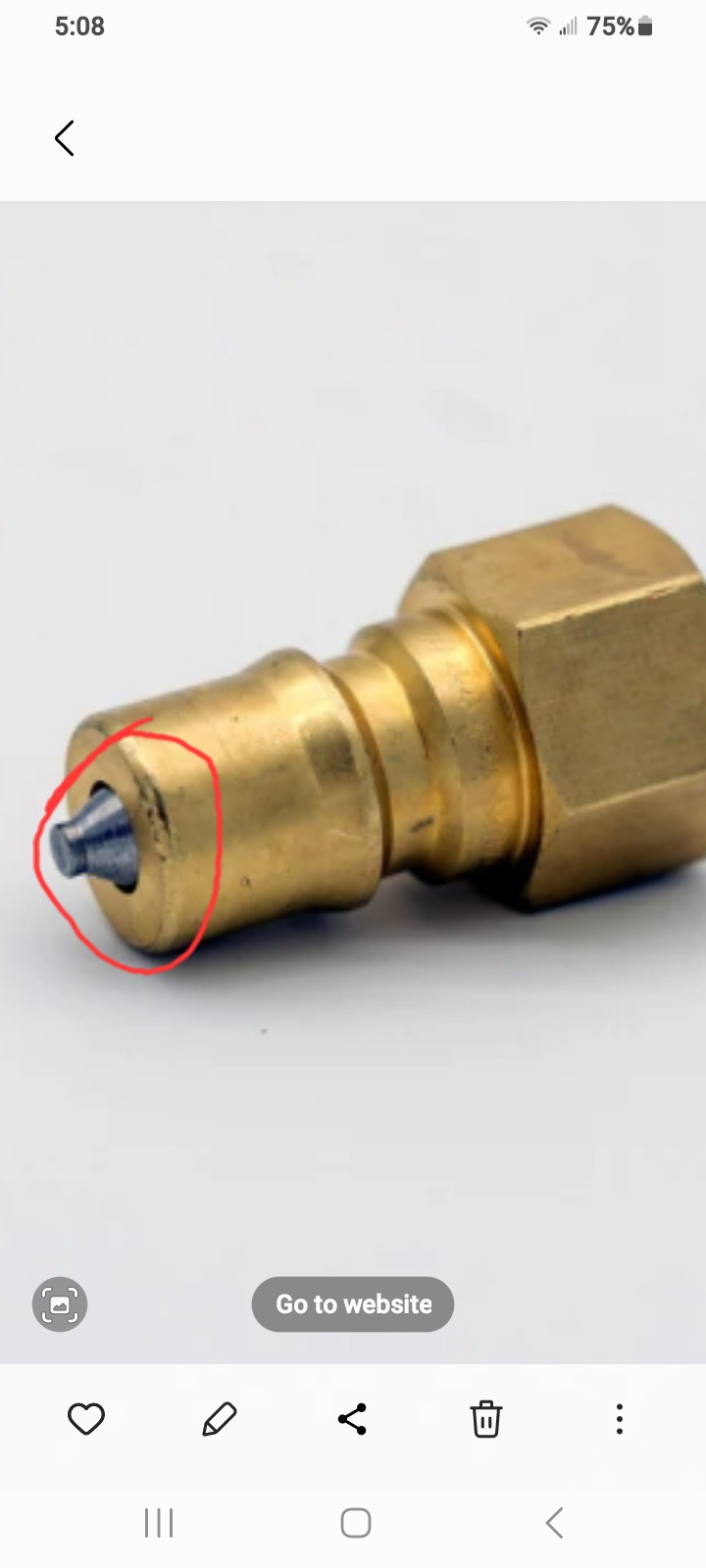

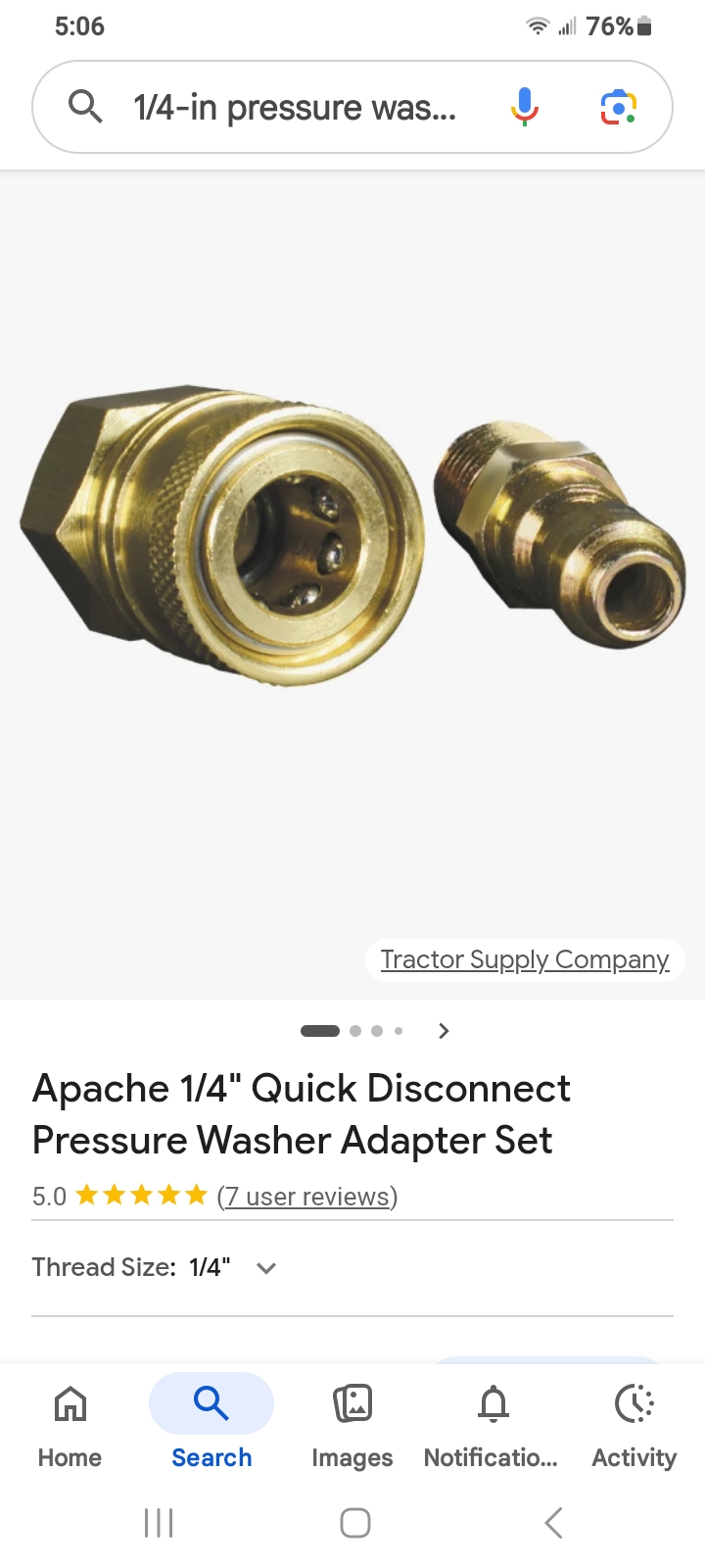

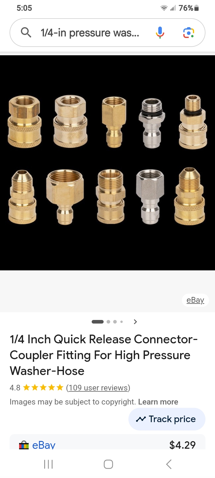

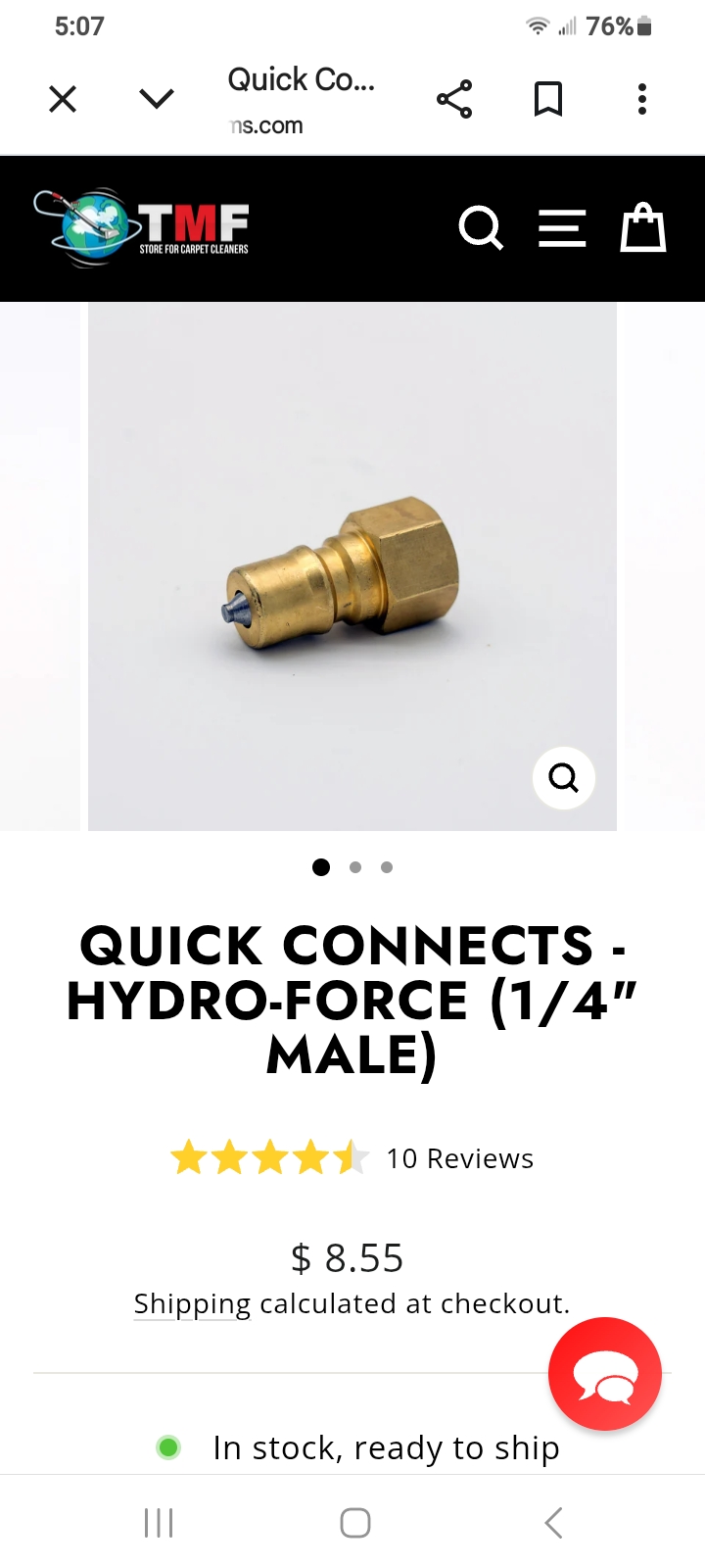

The only thing i can think of is most pressure washer quick connects are straight thru flow and dont have integrated poppets which allows more flow, where as carpet cleaning quick connects have the poppet to stop flow when disconnected but the poppet also severely reduces flow thru the quick connect
